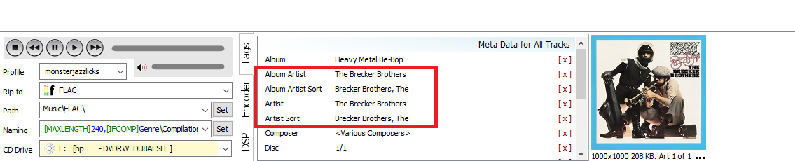

            I ripped a CD by 'The Brecker Brothers'. Please see tagging protocol used (as Inserted Images):

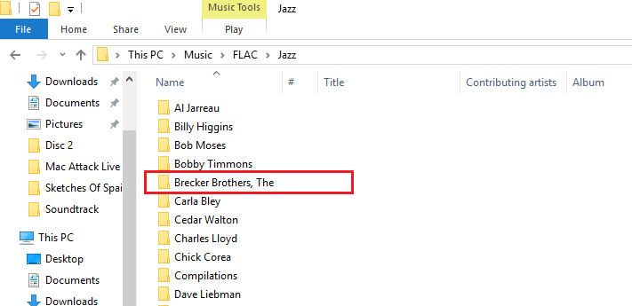

            I would like them to appear in Foobar (and other playback devices/softwares) as 'Brecker Brothers, The' - but the above tagging does not seem to produce this result. Here is how the folder appears (position) in My_Music:
            Many thanks,
            Paul
              • 6189
              #606

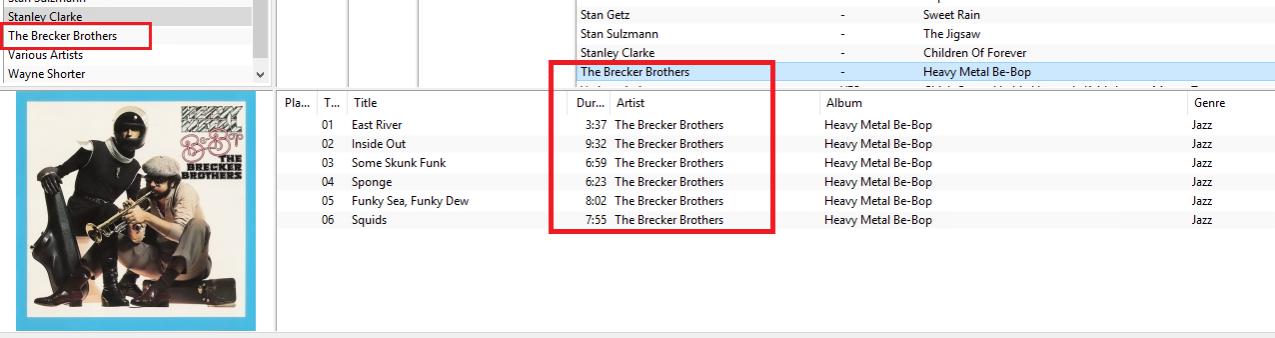

              That's not foobar you show in BB_3. That's your explorer folder listing which is not the tags at all. You've named the folder "The Brecker Brothers", thus it shows up that way. For INSIDE foobar2000 and the tags, I'm sure it does show up as "Becker Brothers, The" using the ARTISTSORT tag.
              • monsterjazzlick
                • 1764
                #607
                Hi Gary,
                Yes, screenshot 'BB_3' is of My_Music on my Windows PC; which is why the preceding sentence reads:
                Here is how the folder appears (position) in My_Music ...
                The above mentioned folder was - as is always the case - automatically created by dBpa. But perhaps the 'naming' was a result of incorrect tagging, on my part?

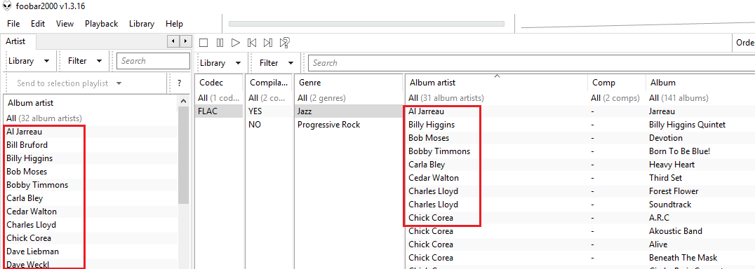

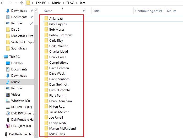

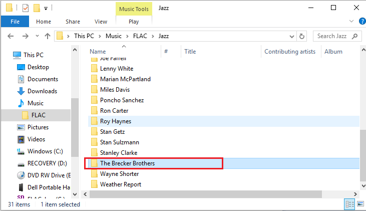

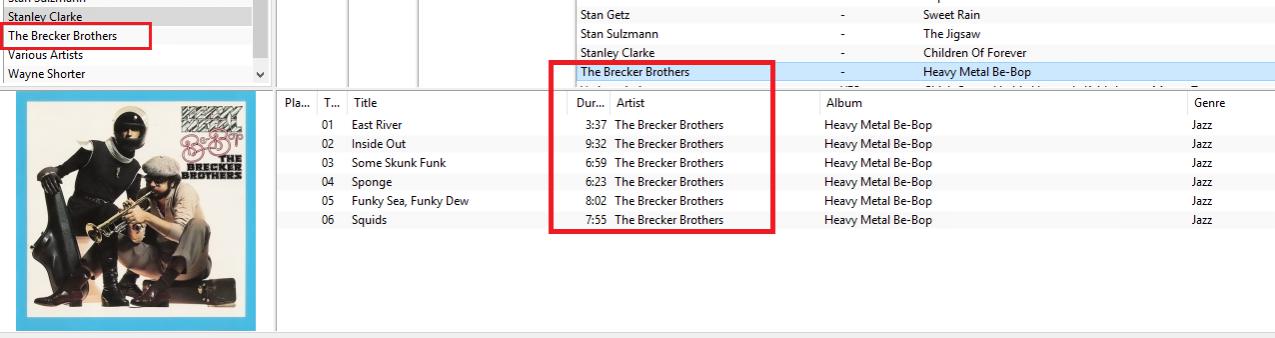

                      I am thinking that the best thing to do might be to manually type: "Brecker Brothers, The" (and same for similarly named bands) in both the ARTIST and ALBUM ARTIST fields. I am guessing that would achieve the desired results without having to switch naming strings.

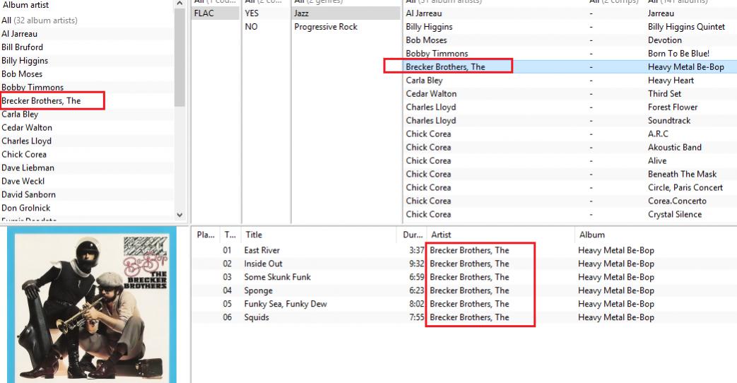

                              Cheers Gary, seems to be sorted now!
                              I will follow this protocol for all such band-names containing 'The'.
