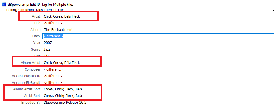

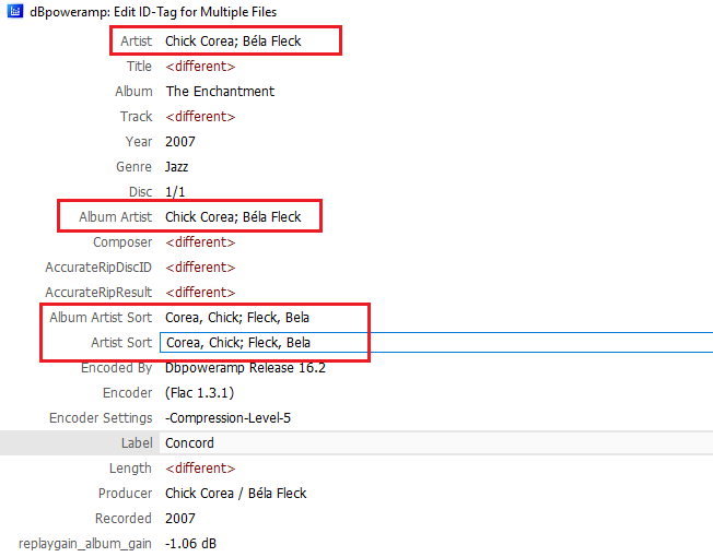

      ... here is how I have just tagged 'Chick Corea with Bela Fleck' CD. As I say, I am thinking this might be a more reliable and solid system of tagging than (say): 'Chick Corea & Bela Fleck'. Cheers.

        Why use sort tags if you're putting things in the same order as regular tag. That's the entire point. ARTIST: John McLauglin and then ARTISTSORT: McLauglin, John.
        Thanks Gary,
        But I am not quite with you - my retard!
        Do you mean that I don't even need to be using an ARTIST_SORT tag at all?

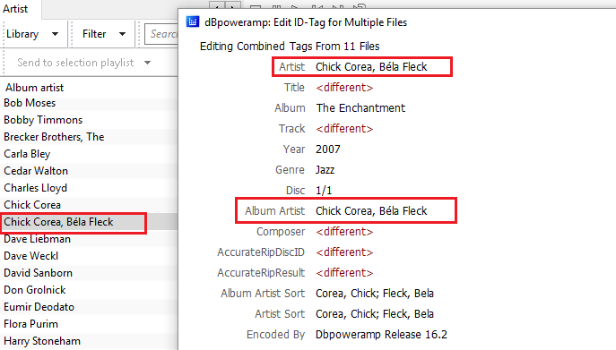

          #634
          ... I think, having experimented with using a 'comma' to replace the 'and' sign, 'Chick Corea, Bela Fleck' (instead of 'Chick Corea & Bela Fleck') looks far more elegant and user friendly.
          ARTIST and ALBUM_ARTIST now reads:
          Paul

            yes. Unless this is actually and album of "Chick Corea & Bela Fleck". If this was the case, I'd have three things:
            ARTIST: Chick Corea & Bela Fleck; Chick Corea; Bela Fleck
            This way there would be a new artist (the combo) and the album would also show up if browsing under the artist Corea or the artist Fleck.
            For example, Graham Nash and David Crosby did some duet albums, so one "artist" in my library is "Graham Nash & David Crosby" but I also want those albums showing up inder Graham Nast and David Crosby as separate artists.

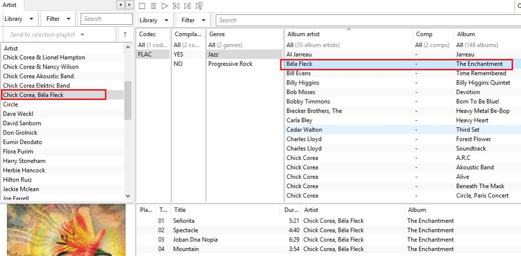

                    Much appreciated Gary,
                    1 - So, if (under ARTIST and ALBUM_ARTIST) you place a 'comma' (ie. Chick Corea, Bela Fleck) then, in foobar, the album ("The Enchantment") shows up ONLY under: 'Chick Corea, Bela Fleck':
                    (I find this first method to be my personal favourite.)

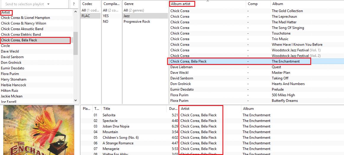

                    2 - And if, (under ARTIST and ALBUM_ARTIST) you place a 'semicolon' (ie. Chick Corea; Bela Fleck) then, in foobar, the album ("The Enchantment") shows up under both: 'Chick Corea' and 'Bela Fleck':

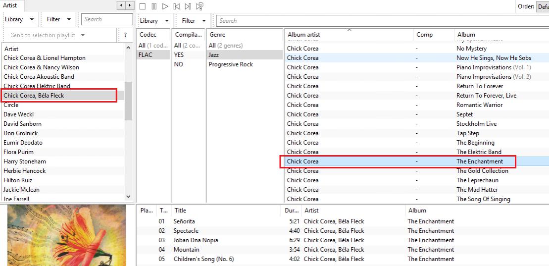

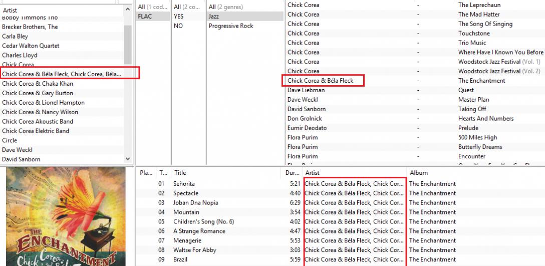

                    3 - Finally if, (under ARTIST and ALBUM_ARTIST) you have a 'semicolon' and use a third tag (eg. Chick Corea; Bela Fleck; Chick Corea & Bela Fleck) then, in foobar, the album ("The Enchantment") shows up under: 'Chick Corea', 'Bela Fleck', and 'Chick Corea & Bela Fleck'!
                    I believe this latter mentioned is the method you you favour; considering "The Enchantment" is a duo album (with not other musicians other than Corea and Fleck)?; and I can see your point. Personally, I find that having the same album appearing 3 times swallows up a bit of real estate (I mean, I would rather just see/find it once).

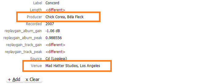

                      Hi Mville,
                      Could I use commas and semicolons (in my tagging) for the following purposes, please:
                      I am planning to do away with the forward-slash '/'.
                      Cheers,
                      Paul

                          Yes, but I don't think you have fully understood the use of multi-value tags and the semi-colon separator. Artist is a multi-value tag. From your screenshot, you have:
                          Artist = Chick Corea, Bela Fleck
                          so artist contains one data value, i.e. one artist Chick Corea, Bela Fleck
                          But your Artist Sort = Corea, Chick; Fleck, Bela
                          so artist sort contains two data values, i.e. two artists Corea, Chick and Fleck, Bela (separated using the semi-colon)

                            Hi mville,
                            Thanks a lot.
                            Damn, I thought I had sussed it! I had been going over your Lennon and McCartney example.
                            So, what, please, should I write in the ARTIST and ARTIST SORT fields? I am dying to know so that I can finally get it right!? lol
                            Should I have written (for ARTIST): 'Chick Corea; Bela Fleck'? I did try this (as per earlier screenshot) but then the same album is placed twice within foobar (ie. under Corea and under Fleck).
                            Cheers,
                            Paul

                              Yes, it will appear twice as you have specified 2 artists. If you don't want 2 artists don't use the semi-colon as it is the separator that tells the software that you have 2 artists.
                              In my example for composer I have:
                              Composer = John Lennon; Paul McCartney
                              Composer Sort = Lennon, John; McCartney, Paul
                              so composer holds 2 composers, with 2 corresponding sort values, which is what I want.

                                Thanks a lot mville,
                                I really appreciate that.
                                Because I don't want the same album to appear twice, then I will leave the ARTIST tag as it is, thanks. But, can I leave the ARTIST SORT tag as it is, please?, ie. with the semicolon?
                                I will post some more questions tomorrow if that's OK, as I plan to make some additional modifications to my current tagging system.
