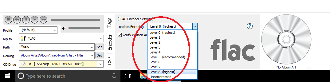

    I very recently joined this forum and have already posted an 'introduction'. I am using the dBPowerAmp 'trial' and have some novice questions:
    Is there an actual manual/PDF/Video/tutorial which instructs how to RIP a CD into FLAC please?
    I would to RIP at like the highest audio quality but am unsure as to which setting I need to choose in the drop-down menu? Please see screenshot.
    There is a 'recommended' level, a 'highest' level, and an 'uncompressed' level?
    Many thanks in advance for any kind assistance offered here.

    See:
    For a step by step guide to setting up.
    All settings for FLAC are lossless, that means they all decode to identical results, identical equals highest possible quality.

      Thanks Spoon.
      So you mean that all of those 10 options provide the exact same results? That's OK, but if so, WHY have all of the different (10) settings?!

        • 1914
        Hey Paul,
        the 10 levels represent 10 levels of slightly different data compression (not audio compression!). So the files only differ in slight different file sizes.
          • 6186
          Thanks Spoon.
          Cheers,
          Paul
          for FLAC, different levels relate to how much (in file size) the FLaC file gets shrunk too (relative to a WAV file). Higher numbers mean smaller file size. But you'll notice that in some cases the size is not that much different. And as spoon points out on the DECODING side, all these FLAC files are bit identical when played back. In the olden days, disk space was not as cheap and some folks liked to eeke out a bit of extra space by using "8" compression. Space is pretty cheap and small these days so not that relevant. Also, in the old days, there were some players that struggled with decoding (playing back) FLAC files compressed at the highest level (my Squeezebox Transporter used to have issues with 24/96 FLAC files at "8", but not at "5").
          Finally (and I'm speaking for myself here, not Spoon) there are a few audiophiles (audiophools?) that are scared of the word compression and have problems with the concept of bit perfect decoding, so for these nervous folks Spoon added the FLAC option of no compression. So essentially, these are WAV files that allow the tagging, etc. benefit of FLAC without the file size compression.
          I've always just used the default FLAC compression level of "5".
