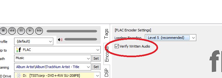

    I made the same mistake in 2007 of using 'Windows Media Player' to rip circa: 300 x CDs. I went with the deafaut format which was 'WMA'. Now, I keep finding that every other album has - usually - 1 x track which is corrupted! Everyone now tells me I should have never used 'Windows Media Player'; but at the time I did not know any better.
    Do I need to check the 'Verify' box, please? (see attach.).

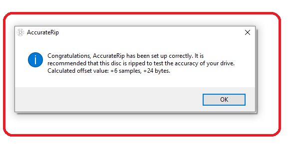

      ... and I am here now regarding 'AccurateRip'.

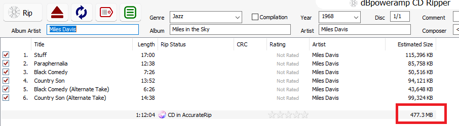

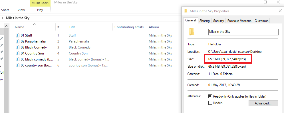

      The ORIGINAL CD (ripped to mp3) size is:

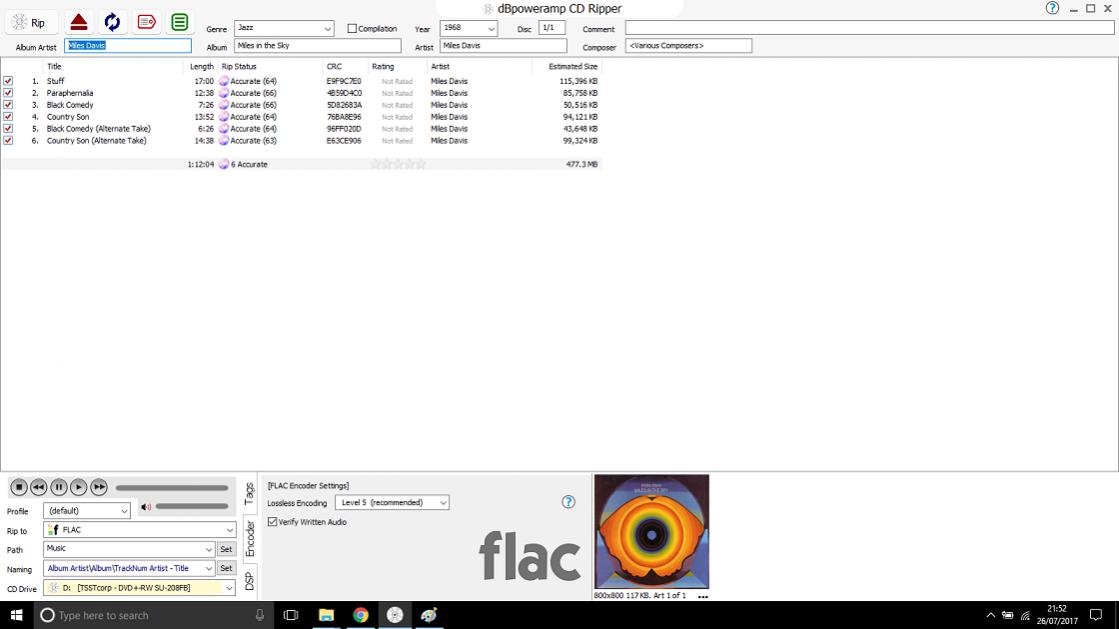

        ... took 10 x minutes to rip a 70 x mins CD at level '5' (Miles Davis: "Miles In The Sky").
        I checked the 'verify' box so I hope that's correct!
        All ripped tracks seem to play OK using 'Groove Music.
        (please see attach.).

          It's not necessary to check Verify Written Audio. Do so if you want to be absolutely certain the files were written correctly. It will take extra time to complete.
          Size of MP3 files vs FLAC: That's the difference between throwing away a lot of CD audio information as opposed to having bit-perfect playback. The actual FLAC file sizes may turn out to be somewhat lower than the estimate. For what it's worth, I ripped an album of over 1hr 20min duration using FLAC compression level 6 that clocks in at about 421MB.
          • Jailhouse
            • Sep 2016
            • 388
            Using FLAC level 6, I can rip a 70-minute CD in roughly 3.5 minutes. Verifying the writes looks to add quite a bit of time to the process.
              • 6189
              #21
              yes, check the verify box. Can't hurt anything! (I guess I'm never in that much hurry).

                #22
                not sure what you're asking, but yes, ripping ultra secure, using ACCURATERIP is the gold standard for ripping CDs. An accuraterip match is extremely informative. It means that at least one other user, with a different copy of the CD, using a different computer, with likely a different drive, got the same exact digital 0s and 1s that you did ripping your own CD. That's confirmation!
