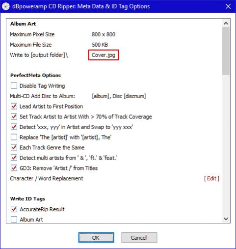

                              Why does dBpa always use the generic naming of 'folder.jpeg'?
                              Because you didn't change the default. I did...
Name:	CD Ripper options.jpg
                              ...although I never use it now.

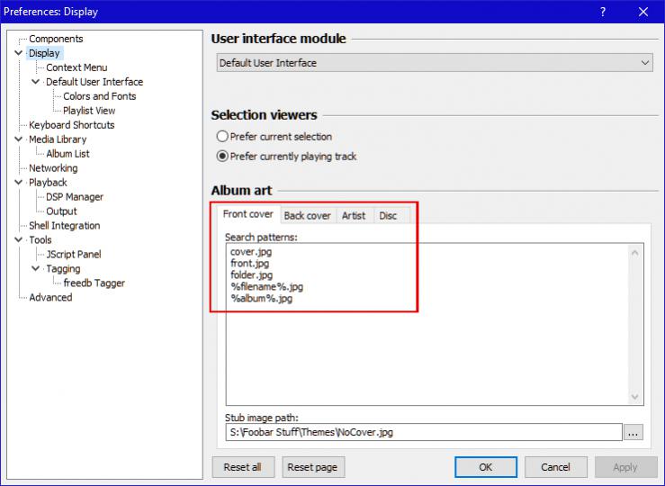

                              Can the user change this to (say) the album name (eg. 'thriller.jpeg')?
                              Yup. Here's my foobar settings for front cover art:
Name:	fb2k album art search patterns.jpg
                              I either added "Cover.jpg" or moved it to the top of the list; I don't recall which. I prefer "Cover.jpg" mainly because I find it to be a better description.
                              N.B. If you use the album name for your cover art, you'll have to make sure the image file is named exactly as it is in the album title tag. I have a hard time getting "Cover" wrong.
