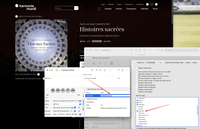

    Thanks for jumping in here! I love dBpoweramp; but want to make sure I have every last configuration set as optimal for ripping my CD collection :-)
    Originally posted by PeterP
    Please check CD Ripper Options / Meta Data & ID Tag / ID Tags / Write ID Tags
    Make sure Catalog # isn't unchecked on the list of tags to write.
    Yes; have checked - and it's as it always has been: checked.
    This screen grab shows an example. Say that I want to rip this CD:
Name:	Catalog number not saved.png
    I think those settings in CD Ripper are correct, aren't they?
    Also, what other program isn't reading the Catalog # tags?
    When I load the ripped files in their folder (named 'CD1' etc) into Yate, there is no Catalog number in that field there.
    Are these tags visible in dBpoweramp itself, if you navigate Batch Converter to ripping output folder, right click some file and Edit ID Tags?
    Yes.
    Thanks for any pointers that you can give, please, Peter!

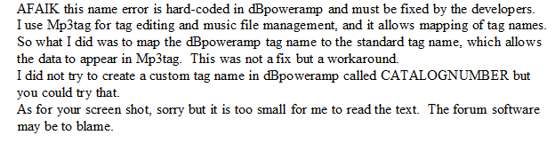

          Originally posted by MarkSealey
          If so, may I ask, please: how would I correct this in dBpoweramp - given my settings as per the grab in my post above?
          AFAIK this name error is hard-coded in dBpoweramp and must be fixed by the developers.
          I use Mp3tag for tag editing and music file management, and it allows mapping of tag names. So what I did was to map the dBpoweramp tag name to the standard tag name, which allows the data to appear in Mp3tag. This was not a fix but a workaround.
          I did not try to create a custom tag name in dBpoweramp called CATALOGNUMBER but you could try that.
          As for your screen shot, sorry but it is too small for me to read the text. The forum software may be to blame.

              Thanks. What I actually did was add 'CATALOGNUMBER' in dBpoweramp itself as a 'new' item; when saved and imported into my tagger, Yate, that field was there as well.
              Solved! Thanks. Your knowledge of the standard did it. Much appreciated :-)
              So sorry :-( I'm partially-sighted myself so I do sympathize.
              On a Mac you can drag any image from the browser (at least Safari and FireFox) to the desktop to look at them in graphics software.
