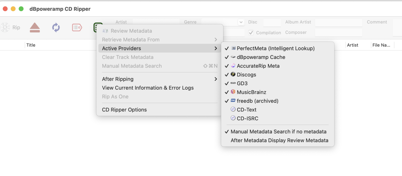

                Following up, if I may: I did try deselecting the sources I don't want. But all of them return on each new launch of dBpoweramp:
Name:	Selections return.png
                Nor can I see a way actually to make MusicBrainz come first as a default.
                Thanks in advance for any ideas here, please…
