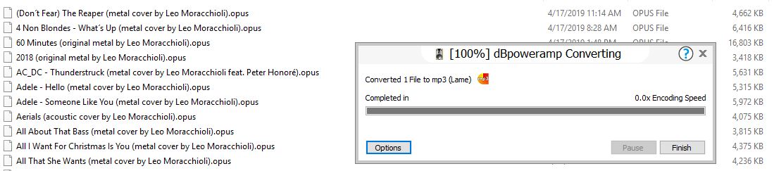

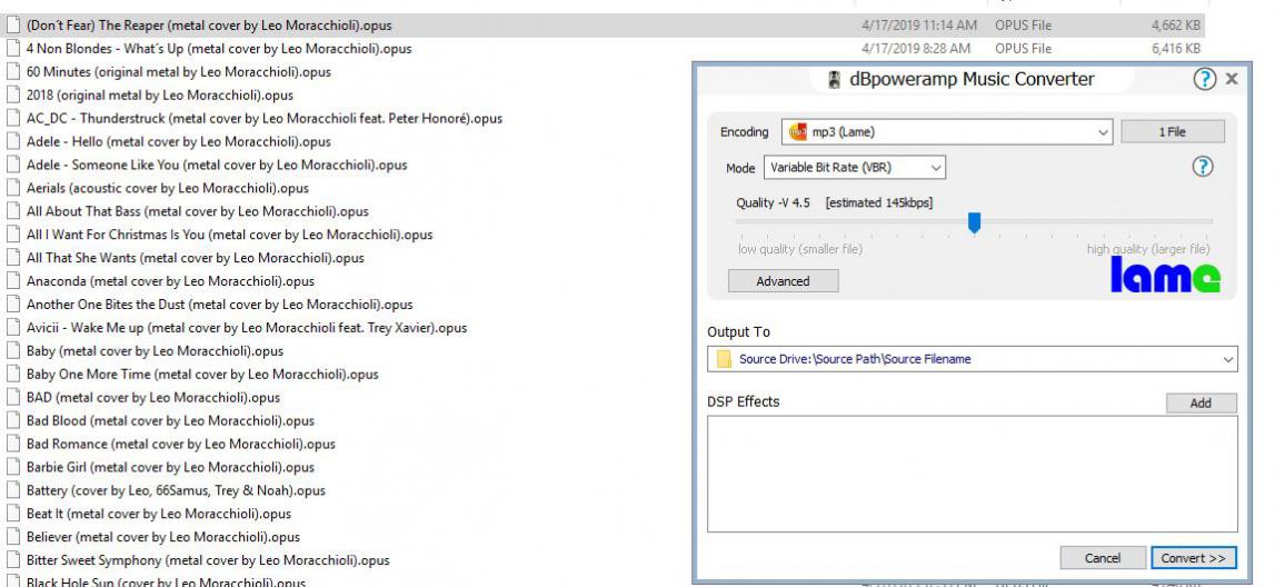

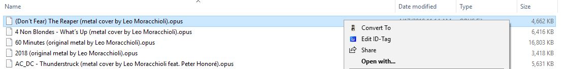

            You are able to select the opus files for conversion? (ie right click on one >> Convert To)
            • Trainerwump
              • Jul 2018
              • 17
              Re: Opus Codec on 64 bit Windows 10 Pro
              Yes that correct.
              I can send you an MP4 of the entire process if you like.

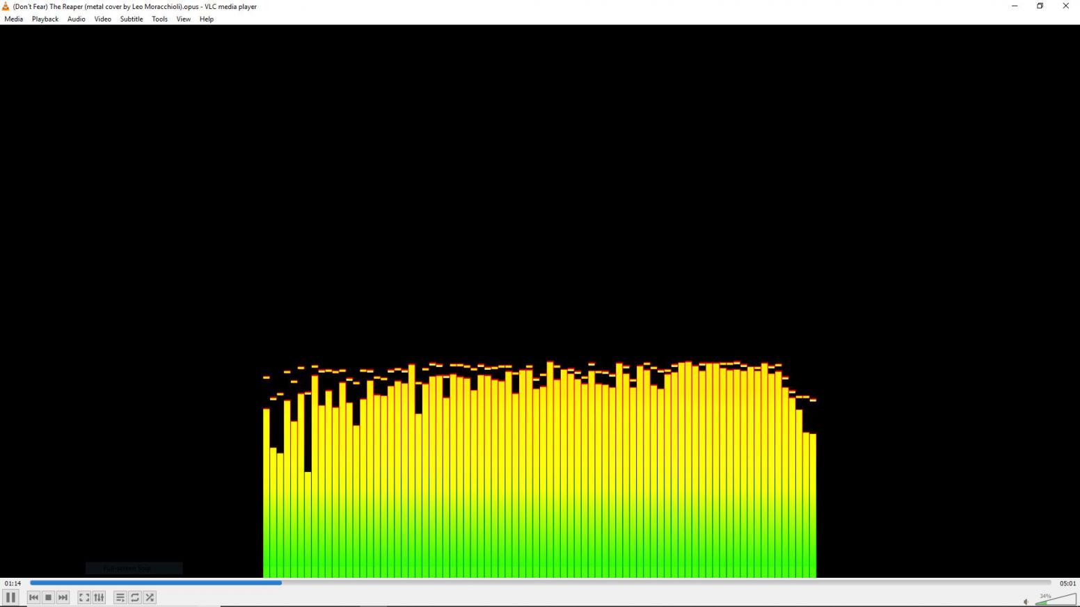

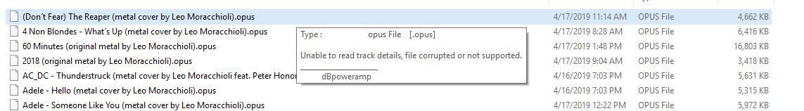

              I have included 2 sets of Jpegs. 1-3 are the conversion process.
              A-B may be helpful. dbpoweramp's codec "recognizes but doesn't recognize the file" but on all media players I tested it plays fine.

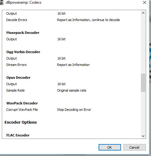

                • 46198
                Look in dBpoweramp Control Centre >> Audio Codecs 'List / Options'
                it should list the opus decoder there, does it?
                • Trainerwump
                  • Jul 2018
                  • 17
                  You are correct it does. Click image for larger version
                  FYI when I upload an opus file (Don't fear the reaper) to and then download the converted file back in it converts it to mp3 fine. Of course the issue is that doing this will A: make all my hair turn white and B: fall out before I get 10% of my library converted. I also have no control over quality and effects doing an online conversion.
                  Thank you
                  -Wump
