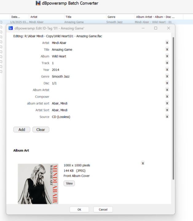

      I don't know... maybe a found a bug.
      If I delete the tag via Batch Converter and immediately look again using Batch Converter it is there (but without a value)
      The PowerShell command (below) to look specifically for that tag also finds it
      PS C:\Users\daveb> Get-ChildItem -Path "R:\Abair Mindi - Copy\Wild Heart\01 - Amazing Game.flac" | Select-Object "Song Rating"
      Song Rating
      So it is definitely there. And this is "custom" tag so I would think it should not reappear. I can see why a standard tag should remain.
          Have you added "Song Rating" to:
          Code:
          dBpoweramp Control Center > Configuration > Advanced Settings > dBpoweramp Reference > Default Tag Edit Fields
          • daveb30
            • Jun 2022
            • 34
            simbun - YOU ARE THE MAN!!!!
            I originally set this up at least 1 year ago and had forgotten that I DID set that tag as a default. I removed it from the default list and my problem has been resolved!
            THANK YOU, THANK YOU, THANK YOU!!!
