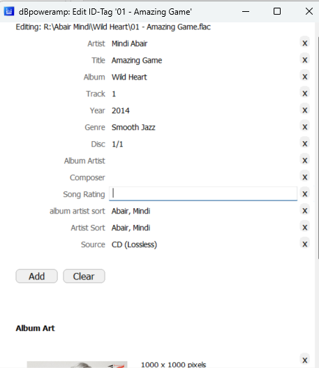

    I have a custom tag that has been added to all of on FLAC files. I generally adhere to old school practices and avoid spaces in names. However, when I view the metadata of my files I see a space. It has been a while since I ripped these but I thought that I gave the custom tag a name without spaces and the description was the only thing that had a space, but it seems I am wrong.
    In Windows I am using File Explorer - right clicking the file - selecting dBpoweramp - Edit IDTags. I am having a few strange things happen.
    I click the "x" to the right of the tag it appears to be deleted. But If I re-open the Edit ID Tags. The tag is still there. The value gets cleared but the tag remains. I have ~20k files so I don't want to do this in this fashion anyway but I could not find a bulk way to do this with dBpoweramp.
    Metaflac lets me do this with a metaflac --remove-tag="Song Rating". if I then do a metaflac --show-all-tags it appears to be gone. BUT when I look at it with dBpoweramp after this (same steps as above) the tag is still there.
    I would also be happy if I would just rename the tag to remove the space
    Can anyone help... THANKS, Dave

                      If you don't use -Count it'll output the entire file, so specify a larger size - depending on how many tags you have - e.g. 2048.
                      If you run the powershell command on a track that does contain a "Song Rating", then on the same track after metaflac removal, the tag should no longer appear.
                      Are you sure Edit ID Tag isn't configured to always show "Song Rating"? It's certainly not showing all your tags.

                        Good catch , my bad... I mistyped. I've been trying everything and mistyped.
                        I was in Batch Converter where I was able to delete a tag from a FLAC file, or so I thought. After deleting the tag, only the value is actually deleted. If I reopen the file and look the tag is still there with no value.
                        In fact this is not just happening to my custom tag. I just deleted Genre and Date. But when I open it back up the tags/fields are still there, just with no values

                              It looks like -Count is a PS 7 option.
                              You could try "HxD - Freeware Hex Editor and Disk Editor" (I won't include a link as it'll take ages to approve), or a tag editor such as Mp3tag (right click the track and select Extended Tags).
                              I don't use dBpoweramp for tagging so I can't test it myself, but I'm sure it's just displaying the placeholder, as it appears to be doing for AlbumArtist and Composer.
