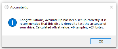

        i went into my part room and grabbed the old GTX 1650 from my old build and my PSU box for the needed PCIE power cable. got that connected and was able to cinfigure accurate rip. so for now im just going to rip the CDs i missed. and see what my options for the issue are.

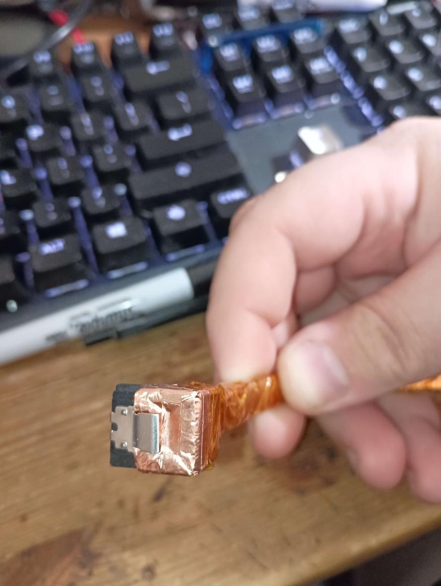

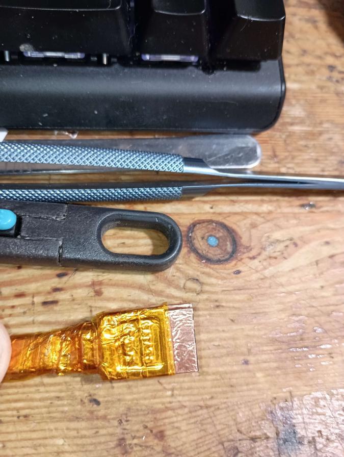

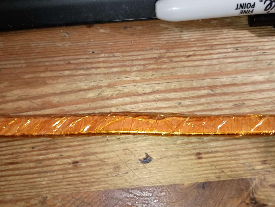

          ok. i fixed it. CD audio is now working.
          the last 2 things i did was wrap a SATA cable in copper tape, and cover that in kapton tape to protect the tape from nicks.

          i also moved the routing of the power cable a little. (im using a 12vhpwr cable direct from my PSU, no adapter) so now its a little further away from the SATA as im sure this high power cable didnt help.
          to summarize this issue as a whole for future reference.
          i had audio that was staticky when i played it from CD or ripped it. sample: https://files.catbox.moe/fy9e3o.wav
          after much hair pulling i traced the issue down to my GPU, but it could have been the power cable routing.
          so i decided to try 2 things to fix this. wrap the SATA cable in metal tape to help prevent EMI (i could have used a ferrite core, but i didnt have any) the tape i had on hand was copper tape i use in soldering. aluminum tape might work too. i also covered the taped up cable in kapton tape, but packing tape could also work for this purpose, but i didnt have that either.
          lastly i also rerouted the power cable.
