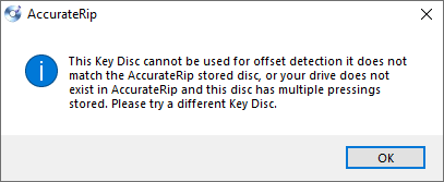

          it says "This Key Disc cannot be used for offset detection it does not match the AccurateRip stored disc, or your drive does not exist in AccurateRip and this disc has multiple pressings stored. Please try a different Key Disc."
          Click image for larger version  Name:	image.png Views:	0 Size:	6.9 KB ID:	325744

            that message appears in both refrence versions i have. EAC has a similar message.
