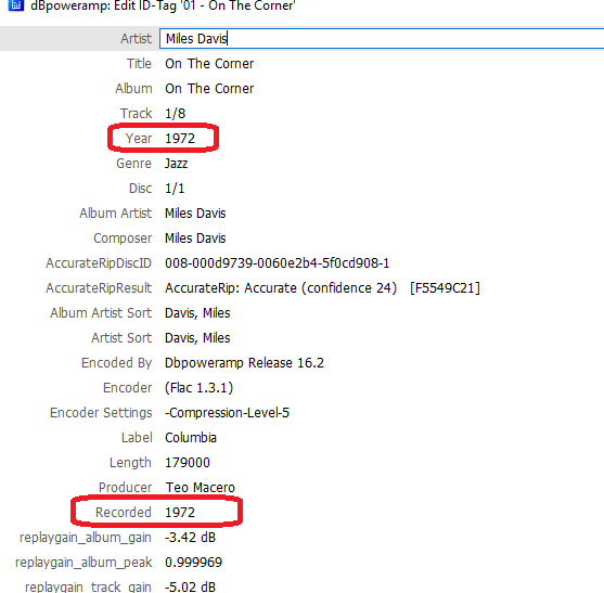

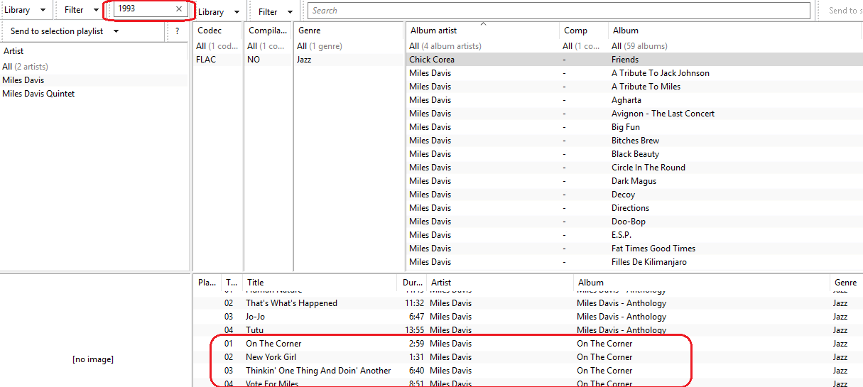

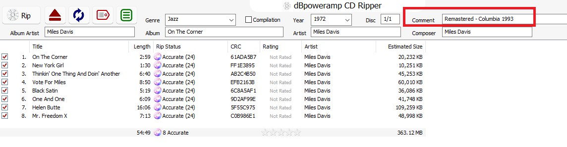

              ... the reason I ask the above question is because, in foobar, I keep getting albums appearing with wrong dates (YEARS). After a good couple of hours this afternoon of trying to fathom out why this was happening, I think I have finally found the root cause. I noticed it happening last month and since then have been trying to remedy it on and off. but to no avail.
              So, for example - if I type in the foobar search: 1992, it calls up the album: "Miles On The Corner". But this album was both recorded and released in: 1972:
              I then remembered that when I has started first ripping my CD collection (last month) using dBpa, I included a COMMENTS tag. In this field I stated the REMASTERED YEAR (in this case ["Miles On The Corner"]: 1992). And therefore, when searching in foobar with the date '1992', it was calling up "Miles On The Corner" (ie. because it must have been reading the COMMENTS tag). Fair enough:
              Then, a couple of weeks ago (with Gary's and Jailhouse's help) I used the 'Batch Converter ID TAG' to REMOVE the 'comments' tag. I also ran it twice again this afternoon - just to be sure. As well as this, I also ran it removing (just in case there were any) all (self-created) 'REMASTERED' tags. When visually checking (in Windows Properties and ID-TAG), nowhere can I see a 'comments' tag appearing:

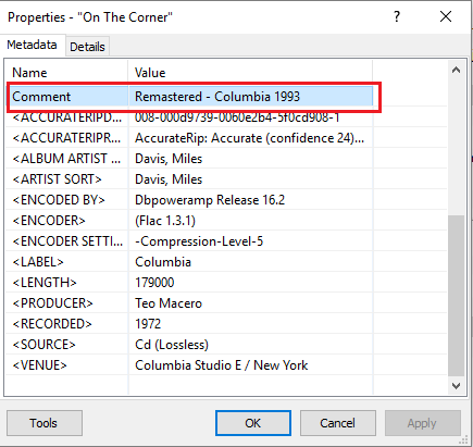

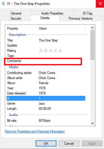

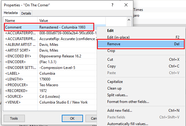

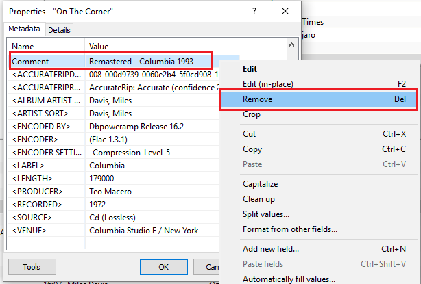

                        I spent an hour or so going through the foobar manual but I still can't fix the YEAR/COMMENT issue. I checked in 'properties' of the music files within foobar (ie. right-click on the file) and the COMMENTS tag was still showing! So I deleted them from a couple of tracks, and the albums, but the changes just won't save - after multiple attempts and restarts.
                        Then I tried to delete (CTRL+A) the COMMENTS tag from everything and (after a couple of minutes of processing) it appeared to have done so. However, when checking again the COMMENTS tags were still there. It's kinda like they are hard-wired (for want of a better word) into the files in terms of how foobar is reading them?!
                        I think the best thing to do now is to uninstall foobar and start over ...
                        Many thanks,
                        Paul

                            Hi mville, I only just noticed this reply, thanks. I have uninstalled foobar since my last post now. And am about to d/l it again; so as to start from fresh. The 'comments' tag is not showing in any of the FLAC files when checking via your method. It only appears when 'right-clicking' (as per above screenshots) within foobar. I mean, they only show up (with the 'Mastering Year') within foobar, nowhere else. But as I say, I am going to try starting over again. Cheers, Paul

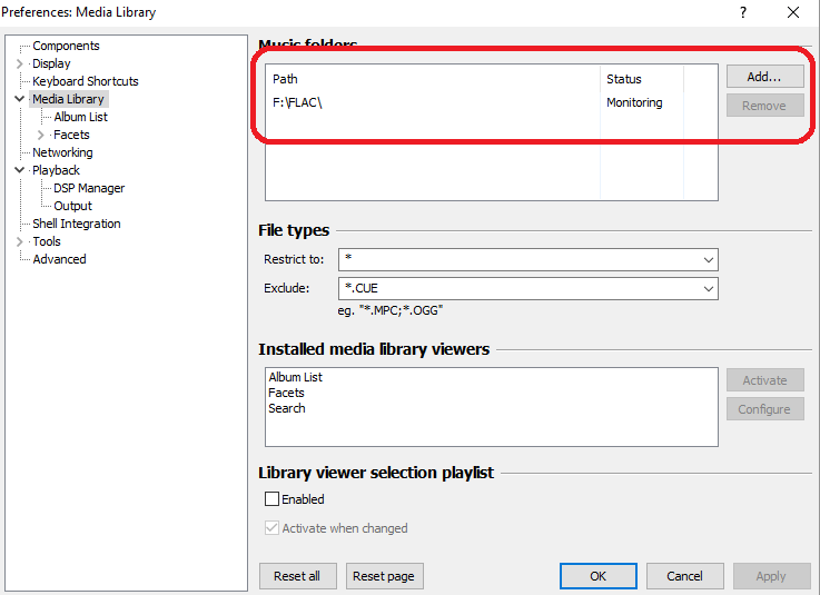

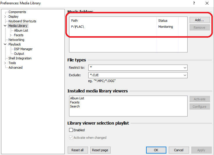

                              Are you pointing foobar2000 to the correct paths in Preferences >> Media Library >> Music Folders?
                              • monsterjazzlick
                                • 1764
                                #45
                                Re: Removing 'Comment' Tag In A Single Pass
                                Hi mville, I am sure everything was set up correctly previously - in the way you describe above thanks. But I will make extra sure it is set as it should be when I configure it later. Thanks.
                                EDIT: and here is screenshot of 'properties':
