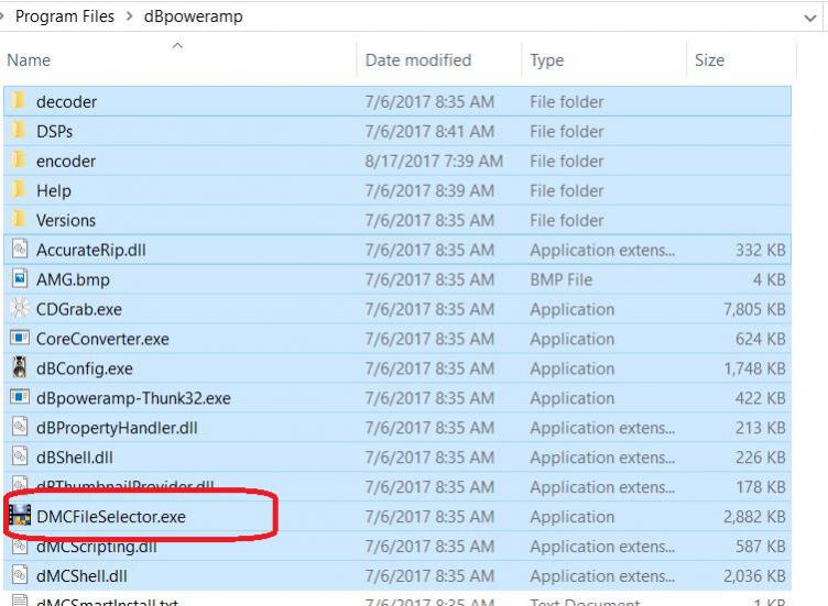

            Re: Removing 'Comment' Tag In A Single Pass
            dbpoweramp batch converter is one of the program that comes with illustrates dbpoweramp (along with CD ripper). Find it in the illustrate/dbpoweramp folder in your programs using windows explorer (called DMCfileselector). Once you find it, start it (double click on it) and once it comes up you can navigate to the top folder of your music files in the left side box, and tick on that folder that to select. then follow the rest of the instructions I gave you. See pic. (p.s. experiment on maybe one album first just to test things rather than selecting ALL your albums).
                All the screenshot shows is the program (DMCfileselector) in windows explorer listing. If you've found the program, you're good to go. Pic won't help any beyond that.
                edit: In fact, I violated my own recommendation. There was really no need for my picture!

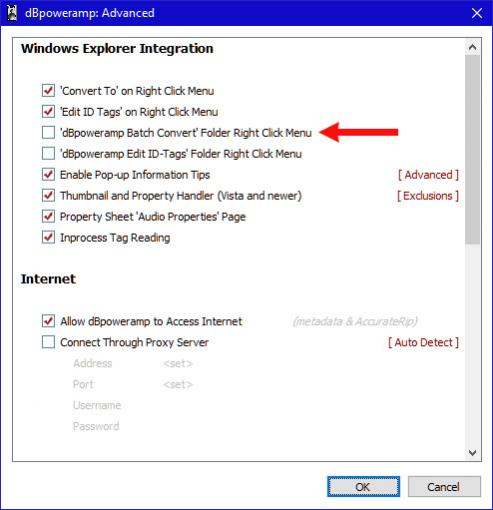

                          Paul, I looked for the Batch Convert right-click option and couldn't find it. It turns out it wasn't enabled in the dBpa configuration. To see if it's enabled on your installation, open Configure dBpoweramp and click on the Advanced Settings button near the bottom of the window. You'll see this:
Name:	Batch Convert right-click enable.jpg
                          Tick the box, click OK, and go back to Gary's instructions.

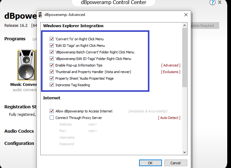

                              Hi JH,
                              Am still waiting for your kind screenshot to be authorised.
                              I do not see the option for TAG ID UPDATE (though it has been d/l and installed)? Here is Advanced Settings window you mention:

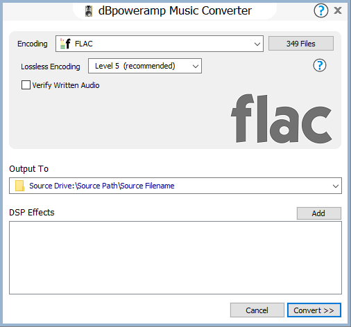

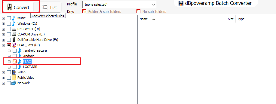

                              And screenshots of Batch-Processor:
