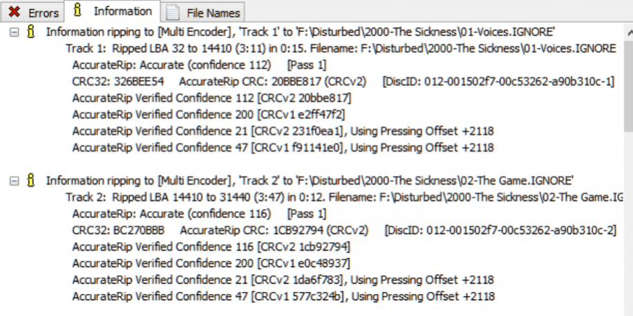

    I'm a new user. I just bought DBPA and a Nimbie NB11. I rip fine with DBPA choosing either my internal DVD player or the Nimbie Opticarc. However, when I use Batch Ripper with the same setting, it seems to rip as it should (as I watched it through DBPA) but the output is only 15kb files. Nimbie cycles through the discs, ejected in front for perfect rips and dropping them underneath for rips with errors.
    I saw in another post to disable antivirus, but that has not helped.
    Here is a copy of a rip:
    Re: Small Unplayable File Size using Nimbie NB11
    As a test, remove the multi-encoder, then rip to just wave, whilst ripping in batch ripper you can right click on the drive line and view CD Ripper (which is hidden).
