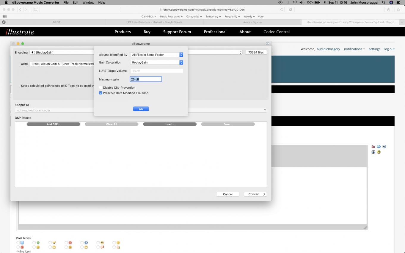

                        I am attempting to apply ReplayGain encoding to 75,000 songs (usually played in iTunes) in dBpoweramp's batch converter using the [ReplayGain] encoding. I'm using Track, Album Gain & iTunes Track Normalization with Albums Identified By as "All Files in Same Folder", "ReplayGain" as the Gain Calculation, Maximum Gain at 25 dB (although I'm unsure about this setting), "Disable Clip Prevention" unchecked, and "Preserve Data Modified Time" checked.

                          By manipulation I just meant "operate" but I haven't been able to get the ReplayGain encoding to cooperate. I play my music in iTunes and I almost exclusively shuffle it. I've set the ReplayGain with Track, Album Gain & iTunes Track Normalization, "All Files in Same Folder", "ReplayGain" as the Gain Calculation, Maximum Gain at 25 dB (although I'm unsure about this setting; please see attached image), "Disable Clip Prevention" unchecked, and "Preserve Data Modified Time" checked.Click image for larger version

                            those settings are good. Mine is set at maximum of 25db as well. That must be the default. Keep in mind that iTunes and iPhones/iPads don't use the replaygain track or album tags in playback. But they use the iTunes track normalization info to "normalize" playback volume. I haven't used iTunes in a while, but on my apple players, I recall that I always had to turn "on" the volume normalization in the players. That is, the apple devices (ipods for example) didn't use the information unless I turned on a setting telling the iPod to use it. Have you done this?
