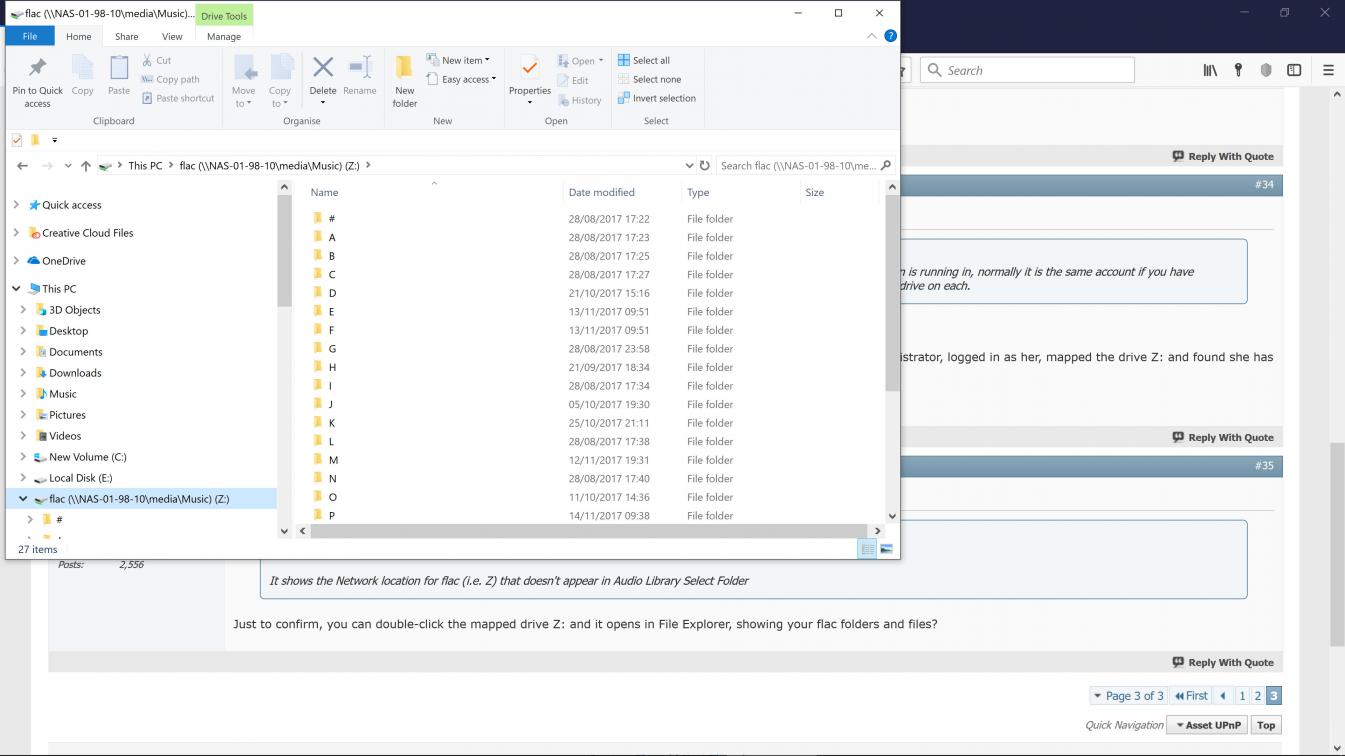

            #35
            Re: Problem scanning library
            Originally posted by Newton John
            [ATTACH=CONFIG]1876[/ATTACH]
            It shows the Network location for flac (i.e. Z) that doesn't appear in Audio Library Select Folder
            Just to confirm, you can double-click the mapped drive Z: and it opens in File Explorer, showing your flac folders and files?
            • Newton John
              • Dec 2015
              • 33
              #36
              Yes, mville, that is correct.

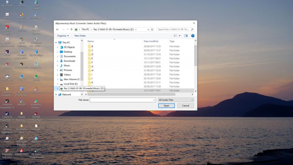

                        Launch dBpoweramp Music Converter. This will open the dBpoweramp Music Converter: Select Audio File(s) window. Are you now able to navigate to the mapped drive Z:?
                        • Newton John
                          • Dec 2015
                          • 33
                          #42
                          Yes, it appears I am: -
