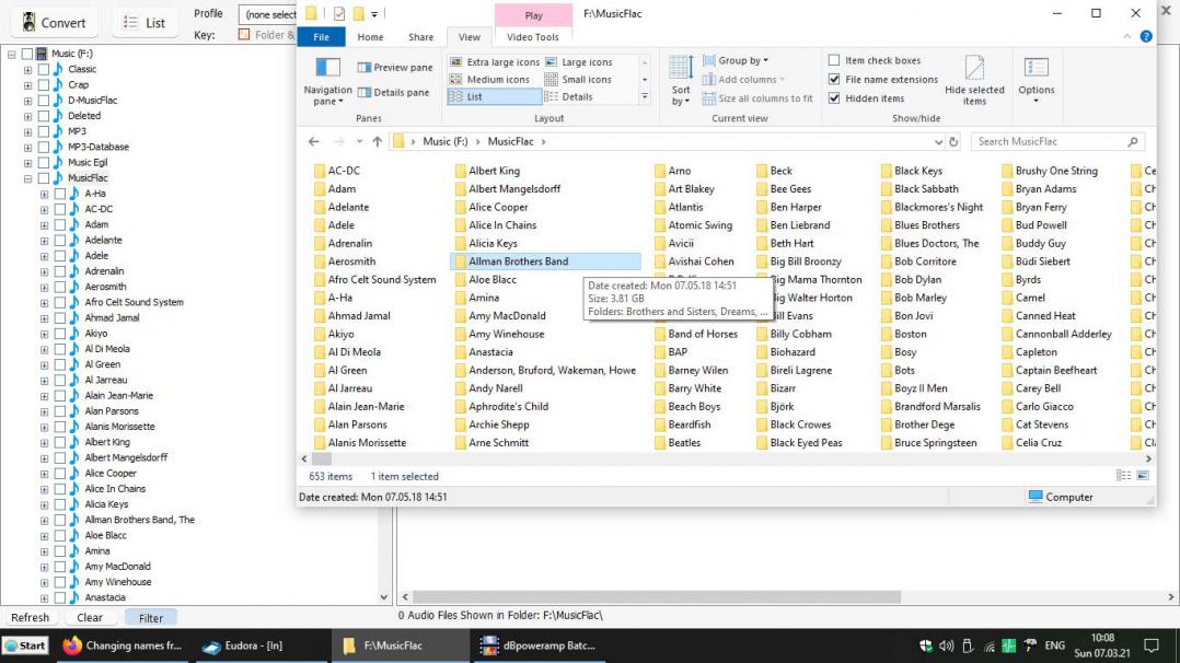

    Hallo Dat Ei (das vom Huhn?),
    I better attached a screenshot for better understanding.
    There you see the folder is named "Allman Brothers" but dbPoweramp automatically shows it as "Allman Brothers, The".
    What the heck??? I'm buffed why...

    Ok, here is a screenshot.
    Thanks again.
    Cheers
    Caesar :-)

    Here are the screenshots since this forum does not allow me to show images.
    http://www.seatemple.com/dbpa.jpg
    and
    http://www.seatemple.com/dbpa1.jpg

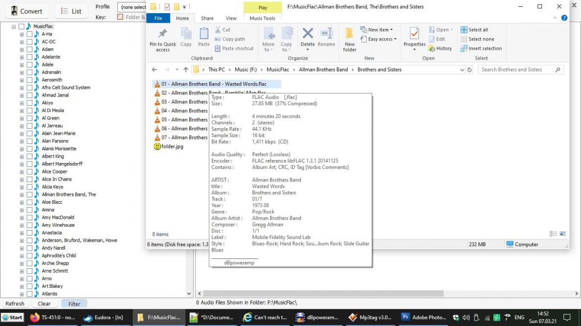

    In file explorer navigate to this file:
    F:\MusicFlac\Allman Brothers Band, The\Brothers and Sisters\01 Allman Brothers Band - Wasted Words.flac
    Right-click on the file, select Edit ID-Tag from the context menu and the dBpoweramp: Edit ID-Tag window should open. Please post a screenshot showing ALL the contents of this window.
