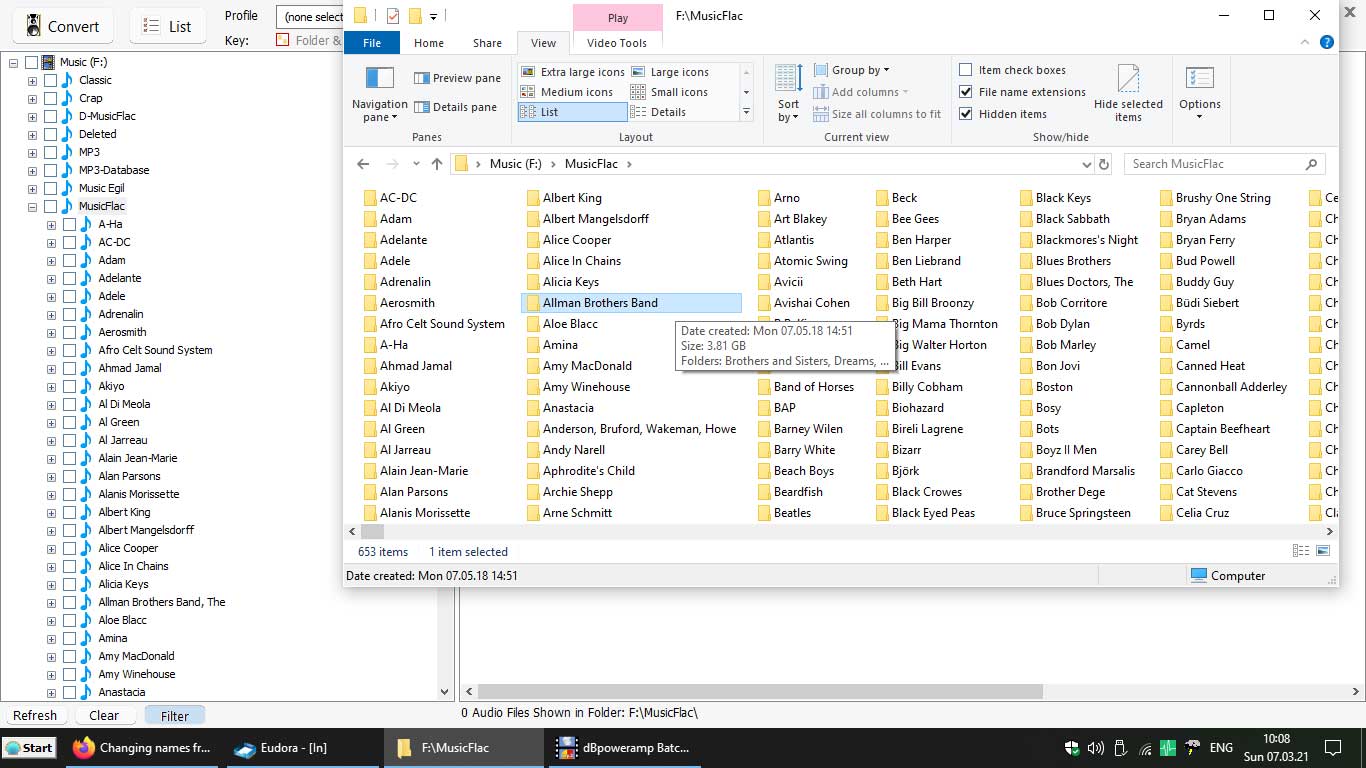

      Hallo Dat Ei (das vom Huhn?),
      I better attached a screenshot for better understanding.
      There you see the folder is named "Allman Brothers" but dbPoweramp automatically shows it as "Allman Brothers, The".
      What the heck??? I'm buffed why...

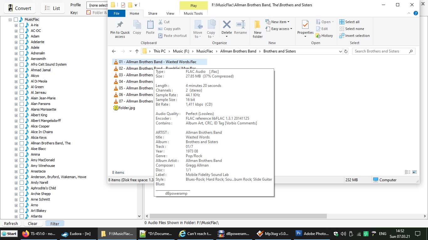

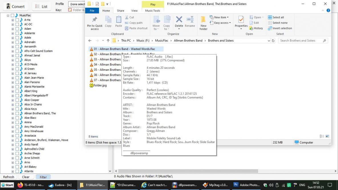

                      Ok, here is a screenshot.
                      Thanks again.
                      Cheers
                      Caesar :-)

                              Re: Changing names from "The ABC" to "ABC, The"
                              In file explorer navigate to this file:
                              F:\MusicFlac\Allman Brothers Band, The\Brothers and Sisters\01 Allman Brothers Band - Wasted Words.flac
                              Right-click on the file, select Edit ID-Tag from the context menu and the dBpoweramp: Edit ID-Tag window should open. Please post a screenshot showing ALL the contents of this window.
