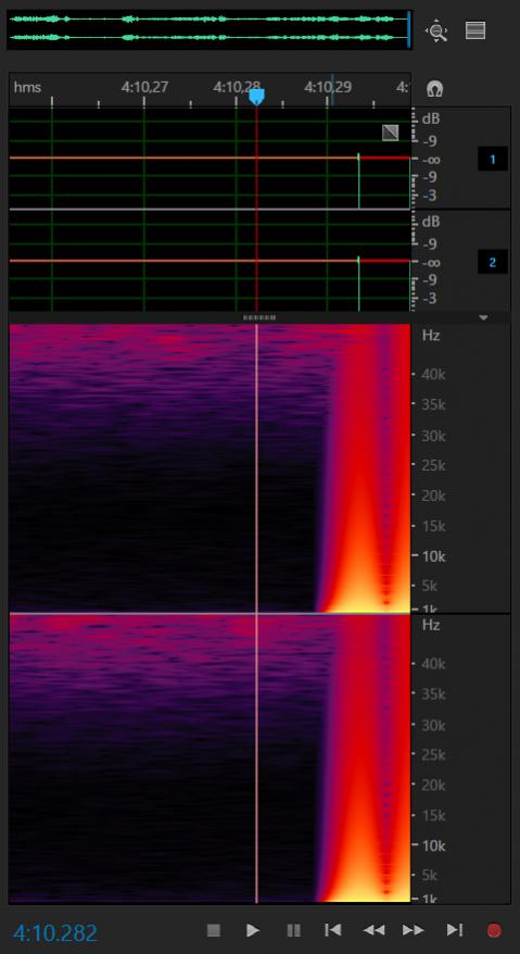

                    • chertk
                      • May 2016
                      Re: DSD Decoder R3
                      Hi Spoon
                      after dsd to flac conversion at the end of the some tracks there is very audible burst (same was with DSD Decoder R2).
                      Here is snapshot from adobe audition:
                        • 46220
                        Re: DSD Decoder R3
                        you can upload a file to dropbox and personal message me a link?
                          • 46220
                          Re: DSD Decoder R3
                          Updated 1st June
                          Fixed issue where could give slight blip at end of track (where end chunk is encoded as zeros)
                          % bar fixed also
