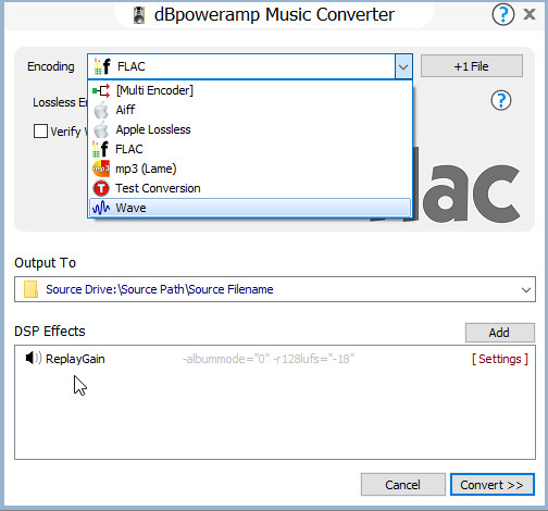

    How do I use ReplayGain to update the tag(s) on a Flac file without converting/resampling the audio file itself. In order to achieve this do I need to use it as a Utility Codec from the Encoding drop-down menu of dBpoweramp Music Converter? I can select add ReplayGain under DSP Effects, but it does not appear as an Encoding option (see attached screen image). Click image for larger version

    An earlier post about this simply says "use the Utility Codec ReplayGain".

    Re: How to use ReplayGain codec to update tag and nor convert file
    Originally posted by db101
    How do I use ReplayGain to update the tag(s) on a Flac file without converting/resampling the audio file itself. In order to achieve this do I need to use it as a Utility Codec from the Encoding drop-down menu of dBpoweramp Music Converter? I can select add ReplayGain under DSP Effects, but it does not appear as an Encoding option (see attached screen image). [ATTACH=CONFIG]1177[/ATTACH]
    have you installed the replaygain utility codec?
    You select files to convert then "convert to" the RG codec(instead of flac etc).
      I have installed ReplayGain from Codec-Central. As you will see from the JPEG I posted, the only option I see in dBpoweramp Music Converter is 'Encoding' not 'convert to'. Am I using the correct application?
        No. That's the Dsp. You haven't installed the RG utility codec. See my link.

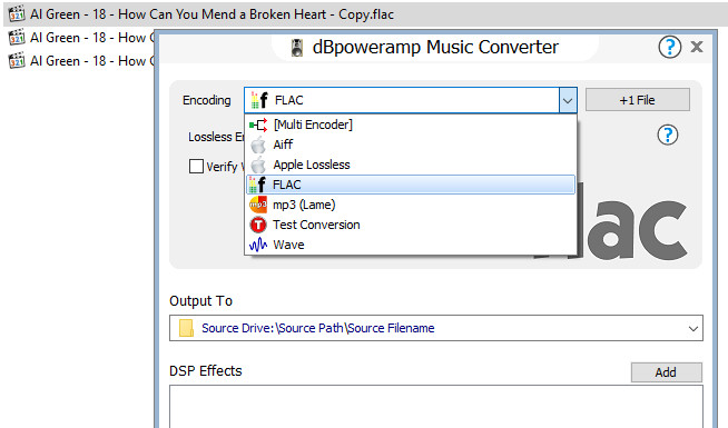

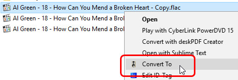

          I have installed the RG Utility Codec dBpoweramp-Codec-[ReplayGain_R5].exe
          When I follow your instructions to select the file in Windows Explorer and then look for "the RG codec(instead of flac etc)" as you suggest, I do not get an option to select an RG codec, as you will see from the attached JPEGs.
          Perhaps I'm still missing something, but the procedure does not appear to be straightforward to me.

            • 6189
            [ATTACH=CONFIG]1178[/ATTACH][ATTACH=CONFIG]1179[/ATTACH]
            it appears that the replay Gain UTILITY codec is not fully installed. See pic. You should see in drop down.
