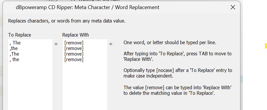

                  thanks Spoon. That didn't work. I had already tried the refresh button. This is what I have.

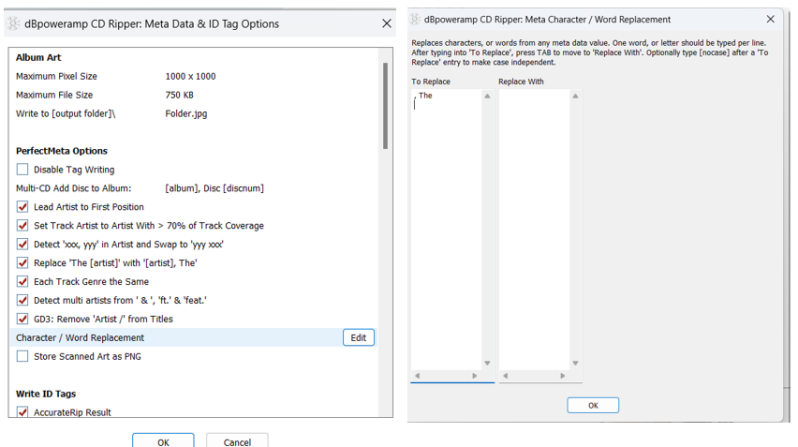

                    If you have the option 'Replace The Artist with [artist], the' as the source of ,the, then likely this happens after the word replacement,
                    • dzangger67
                      • Nov 2023
                      • 29
                      it was checked, putting ,The at the end. I would prefer that because it's easier to detect ,The instead of The because some bands have the word in their names. Any chance we can use regular expressions like ^The to indicate only The at the beginning of the name should be replaced?
