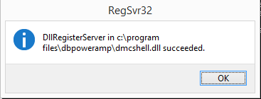

                    #39
                    Re: How do I get right click menus to work?
                    Lets see what Windows says about the dll registration:
                    press start menu and type: cmd
                    at the top of the menu will be 'cmd' shown, right click on it and select Run as Administrator.
                    type:
                    regsvr32 "c:\program files\dbpoweramp\dmcshell.dll"
                    A popup text box will appear with status of registration, press CTRL+C on this popup to copy the msg and paste results here. This only applies to those with no entries on the right click, for the person who has Edit ID Tag not working on right click (but convert to does work) send an email please (about >> email above)
                    • Vanblerk
                      • Feb 2015
                      • 21
                      #40
                      Hi Spoon,
                      This is what comes up:
                      No idea what this means!
