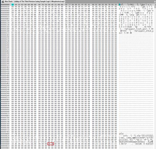

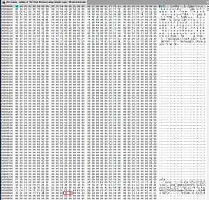

                            See this image: [SIZE=4]s01.geekpic.net/di-D9CWUP.png[/SIZE] (You'll have to cut & paste it, as otherwise once again it'll need mod-approval).
                            The attached image clickable below will probably show up as way too small. (What's up with these forum images not being able to be enlarged?! ) :/
                            I've [SIZE=3]highlighted the 2 bytes[/SIZE] that need nullifying to [SIZE=3]00 00[/SIZE] to fix my issue.
                            If anyone knows how that can be done with a script somehow, please let me know. Unfortunately, it's in a highly transient part of the header and any Tag changes will move it's position, so it's position needs to be carefully plotted, with some good MP3 knowledge. You cannot just assume it will be in a certain fixed position in the file, and of course almost every single MP3 file will have it in a different location, because of all the differing Tag/header info.
