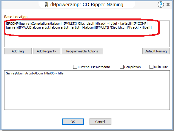

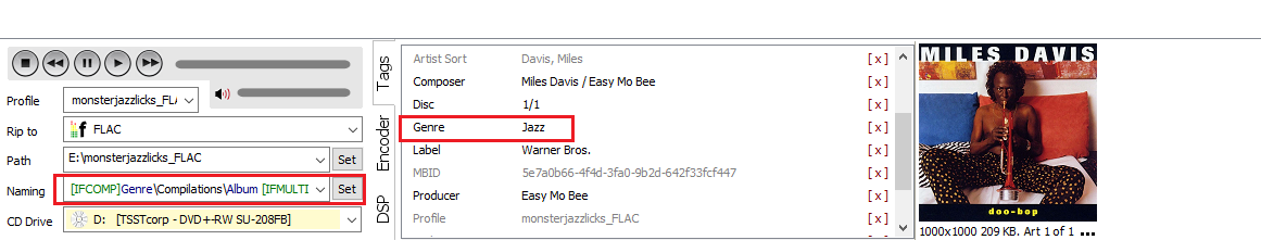

    OK, I pasted in the 'string' and then ripped a couple of CDs (making sure all 'genres' were set to 'Jazz'):
    Now, it did create a 'Jazz' (genre) folder and placed my most recently ripped two Miles Davis FLACS within it; but it adds the Artist's NAME to (the start of) each Album-folder title. So you get the Artist's full name followed my the Album name (eg: 'The Beatles - Yellow Submarine'):
    1) Do you leave it like this?
    2) Can you set 'dBpa' so that it omits the name of the Artist?
    3) Or can/do you simply DELETE this info. if preferred?
    Thanks a lot.

              sorry. typo. try this:
              [IFCOMP][genre]\Compilations\[album] [IFMULTI] \Disc [disc][]\[track] - [title] - [artist][][IF!COMP][genre]\[IFVALUE]album artist,[album artist],[artist][]\[album][IFMULTI] \Disc [disc][]\[track] - [title][]

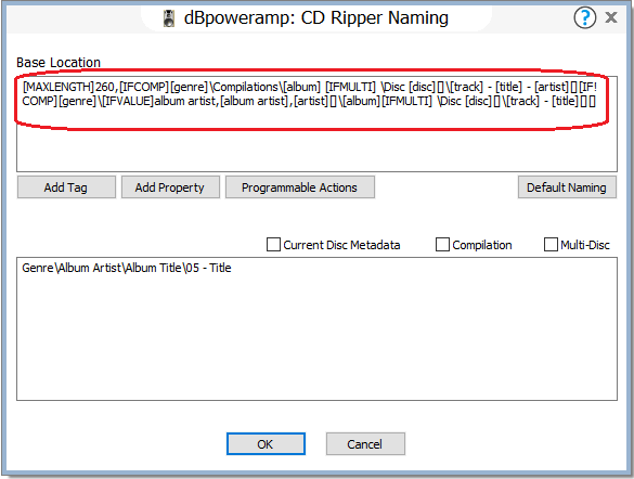

                  excellent point mville. This is most likely an issue with classical (very long names). Given that he's using music files on an external HD, there is really no reason for him to have the really long path such as "C:\Users\xxxx_xxxxx_xxxxxx\Music\monsterjazzlicks _FLAC". He should really just have the path as "E:\music\genre\......" (assuming the external drive is E
                  edit: or just use maxlength. this should work (although I'd still shorten the fixed path part as noted above):
                  [MAXLENGTH]260,[IFCOMP][genre]\Compilations\[album] [IFMULTI] \Disc [disc][]\[track] - [title] - [artist][][IF!COMP][genre]\[IFVALUE]album artist,[album artist],[artist][]\[album][IFMULTI] \Disc [disc][]\[track] - [title][][]

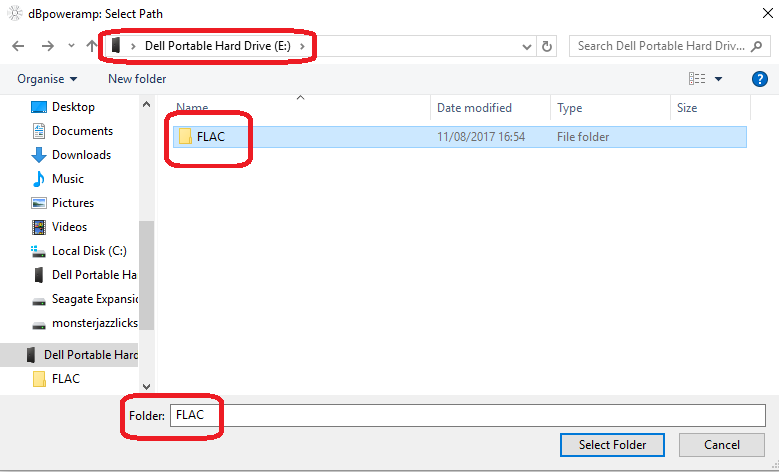

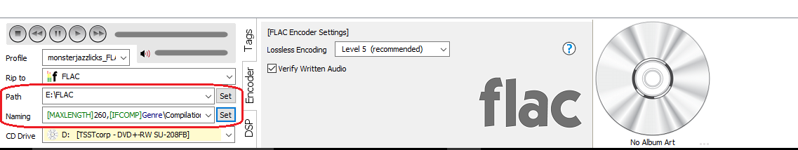

                    Mville - OK, I have changed the name now of the folder on my external-HD so as to reduce the name-length (to just 'FLAC').
                        Gary - I just made a rip using the new kindly given 'string'. Did you make a modification in that now it does not add the Artist Name to the start of the Album Name? I just noticed it says: "Miles Smiles" instead of (as before version): "Miles Davis-Miles Smiles". Cheers.

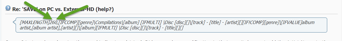

                          Now, just reduce the MAXLENGTH down a touch, to say 240 (so you can copy the odd file later, for say testing purposes. You won't get so many Windows warnings, which can be a real pain).
                            #28
                            Re: 'SAVE' on PC vs. External-HD (help?)
                            Yes. But I also fixed that problem for you several posts back, maybe in your other thread. But yes, the newest version does what you want now. But change the 260 to 240, as per mville's good suggestion.

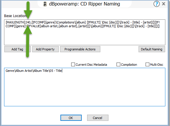

                              Mville - thanks for bearing with me! So - in 'dBpa' - I change the '260' value down to '240' as per screenshots, please?:

                                #30
                                I can't see the screenshots. I get the Invalid Attachment specified error.
