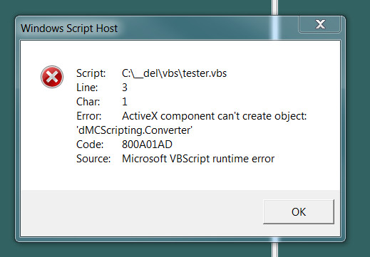

              it is 2017 and has been over 9years since the last post on this thread.
              It is rather troublesome that I am still getting the same error and do not see any resolution to create activex object on windows 7 64-bit OS.
              i have dBpowerAMP Music Converter 16.2 installed on windows 7 64 bit OS.
              It works fine by itself.
              I am getting the same error as everyone in this thread, but 9 years later.
              this is a tester script:
              Wscript.echo "test dmcscripting"
              Set WshShell = CreateObject("WScript.Shell")
              Set dMC = CreateObject("dMCScripting.Converter")
              errors on the last line.
              It would be absolutely thrilling to finally solve this issue once and for all after all these years.
                • 46122
                #22
                Re: ActiveX component can't create object: 'dmcScripting.Converter'
                Try to uninstall dBpoweramp, full reboot of windows then reinstall.
                If you have any security software try to disable as a test before install, or run your script.
                • aabra1
                  • Sep 2017
                  • 8
                  #23
                  uninstalled
                  reboot
                  disabled AVG
                  installed
                  another reboot
                  run tester (same error)
                  started Batch Converter
                  so it does not work
                  Do you have any other advise?
                    • 46122
                    #24
                    Are you able to try a different pc?

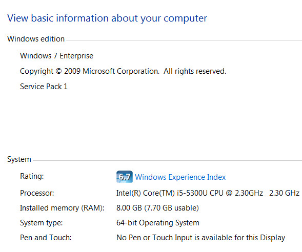

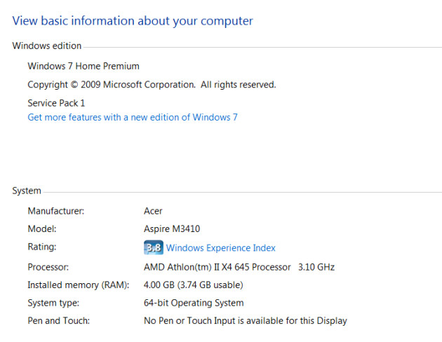

                        #26
                        The fact that it works on Windows 10 Pro does not suggest anything to me.
                        I tried it on 2 entirely different hardwares [desktop(Click image for larger version
ID:	293625) and laptop(Click image for larger version
ID:	293626)] both 64-bit windows 7.
                        both error on the same line trying to create object.
                        It only suggests to me that even though it is fully functional on 64-bit win 7 machine it does not to instantiate dMCScripting.Converter object.
                        Why that is? I do not know.
                        Probably dll is not registered correctly by the installation package.
                        i tried to reregister dll with regsvr32.
                        it did not change anything.
                        perhaps windows 7 scripting engine does not see this object for whatever reason.
                        Does anybody have any smart ideas how to fix this situation. other that switch to windows 10(that is not an option).
                        thanks

                              #29
                              ActiveX has in the past been used as an exploit by malware writers. I wonder if it's being blocked for security reasons. I would check Windows and/or antivirus settings.
                              Could it be a permissions issue i.e. user does not have FULL administrator privileges?
                                #30
                                I tried it on 2 entirely different hardwares [desktop([ATTACH=CONFIG]1701[/ATTACH]) and laptop([ATTACH=CONFIG]1702[/ATTACH])] both 64-bit windows 7.
                                It suggests that given certain conditions it IS working, rather than the previous posts that allude to it not working.
                                What we need to do now, is work out why it is not working on the Windows 7 64-bit OS.
