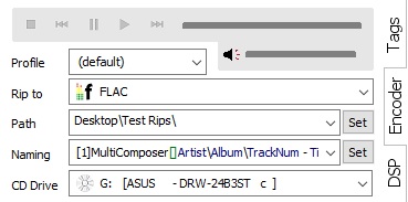

              Ok, uninstalled everything then reinstalled. It's working but not ripping in the format I would like nor is it ending up on my external drive. Sorry, I wish I was a little more technically savvy. I feel like I'm getting really close though!
              • ghibliss
                • Jun 2013
                • 60
                Re: Batch Ripper and Nimbie USB+ on Windows 11
                Select your ripping format and select the path where you want your files to go here:
