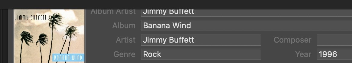

          New issue with Beta... It is cutting off the top of the first line in the upper dialog box, along with the top of the album artwork. Please see attached. Also, the insertion cursor is apparently not completely fixed, as the cursor appears (or not) seemingly randomly. Thanks! Jon K.Click image for larger version
Name:	PT-Cut off top of Album Artist.jpg

                  • 1654
                  Thanks for all the reports, new build in the making.
                    • 1654
                    New build released:
                    https://www.dbpoweramp.com/beta/PT-2024-07-23.dmg Main changes: New appearance of Edit ID Tags window. Fixed erratic behavior of column resizing in ID Tags tool. Various cosmetic fixes. Build 2024-07-19 changes Reliably refresh ID Tags files views when editing tags. Restored remembering of Edit ID Tags window size.
                    Can't recreate last column sizing issues, tested latest (Mac OS 14) and lowest supported (Mac OS 11) systems. It's sometimes hard but not impossible, perahps there's another factor that I missed. Any window management customization apps or non-Apple mouse drivers running?
                    I made scroll bars always visible in ID Tags file lists for now, which should mitigate this.

                      Peter,
                      Whatever you did fixed both the last column resizing problem and the cutting off of the top of the window. Plus, as you expand the last column, it no longer crunches any columns to its left! And, I can confirm that the size of the Edit Tags window is now sticky, and the tags are refreshed after the edits are complete. Problems fixed! THANKS!!
