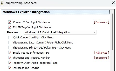

                          • CJIgel
                            • Sep 2008
                            • 8
                            Do you mean 'advanced settings' with 'Show more options'?
                            I had already deactivated it and activated it again.
Name:	Screenshot 2024-11-12 210659.jpg
                              • 46139
                              Yes, does the classic shell items work?
