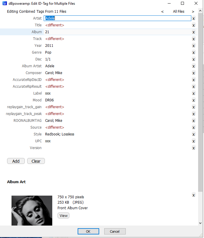

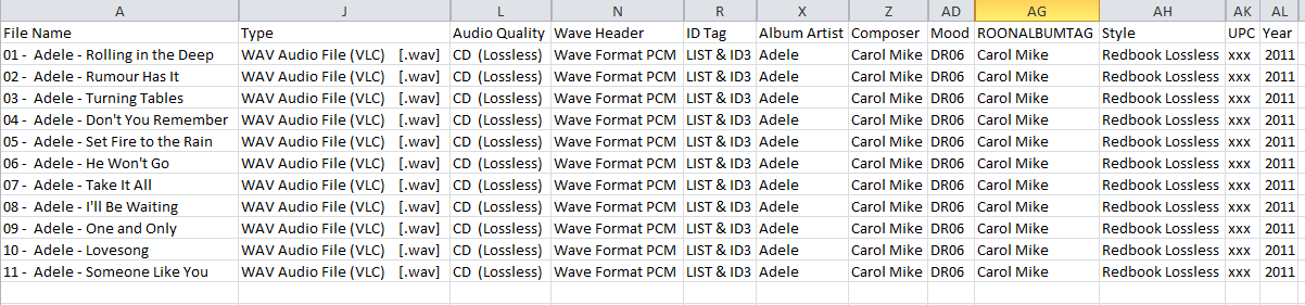

    Just to add to the above.......Asset is confused (and so am I) with regards to the browse views I'm seeing. I've attached some screen shots that seem to indicate that "Edit IDTag" and the "Audio Output codec" are interpreting the field delineator (semi-colon) differently. I've used two albums (Adele and Bear's Den) as examples.
    Adele First
Name:	Adele IDTag.PNG
Name:	Adele Audio Output.PNG
    You can see that the tag delineator is being interpreted differently?
    IDTag
    Composer = Carol; Mike
    Style = Redbook; Lossless
    Audio Output Codec
    Composer = Carol Mike
    Style = Redbook Lossless

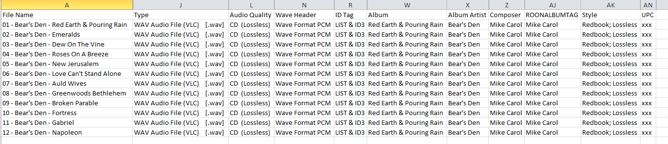

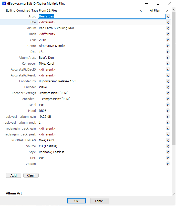

    Bear's Den
Name:	Bears Den IDTag.PNG
Name:	Bears Den Audio Output.PNG
    IDTag
    Composer = Mike; Carol
    Audio Output Codec
    Composer = Mike Carol
    I wouldn't normally expect to see a view in Asset/Style of "Redbook; Lossless" but I am and all the albums seem to be now split across three categories (Redbook, Lossless and Redbook; Lossless)
