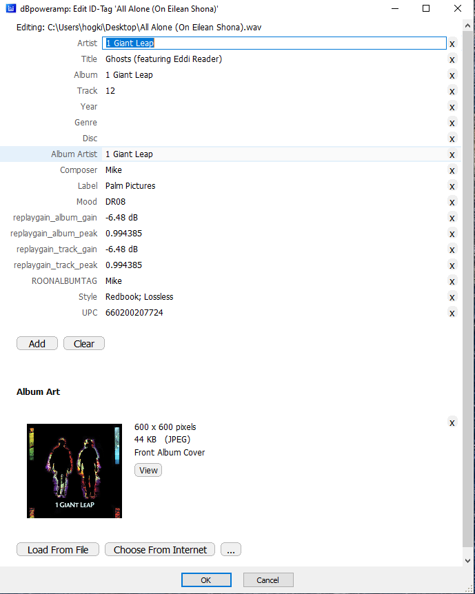

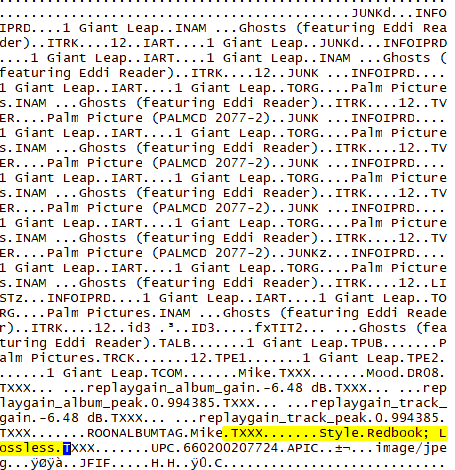

          Just working through my library and so far so good, however, I have noticed that I have a certain number of rips where I have specified multiple values in the Style field (all separated by "; ") that are not being written into the file as separate tags but rather as a single text field. The rips that work correctly all show multiple Style tags being written into the file as separate entries which I believe is correct for ID3v2.
          I've attached a couple of screenshots; one a hex view of the relevant part of the file and another of the IDTag view. Any thoughts how to fix this please?

            So far so good in the conversion from Content Group to Style; all complete. However, I've got a certain number of rips where
            the Style tag has multiple values (all separated by "; ") that are not being written into the actual file as multiple
            Style tag entries but rather a single Style tag containing all values as a single entry.
            All the other rips with multiple Style tag entries are written into the file with multiple Style tag entries which I believe
            is the correct method for ID3v2.
            I've attached a couple of screenshots; one a hex view of the relevant file section and another of the IDTag view of an example file.
            Any thoughts on how I can fix this please?

              • 46086
              #21
              Re: Style/Content Group Tag Issue
              ID Tag processing with the option set 'Multiple Artists from 'Artist1; Artist 2'', this should put correctly using the latest version.
              • Husqcat
                • Nov 2011
                • 40
                #22
                Just tested it on a couple of albums and indeed it does, thanks
                What does that setting actually do, I know you mentioned it earlier but thought you were talking about something else as I was referring to Style and setting refers to Artist but seems to work?
                  • 46086
                  #23
                  Yes it will work on any tags.
