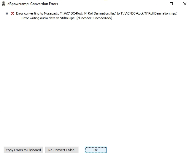

    I have found a file that will not convert to MPC. I have the same file converted to Wav, Flac, Opus, M4A, Wv, MP3 all without issue. But when I try to use any of those files to convert to MPC I get a 14kB file and the following
Name:	MPC Error.jpg
    I can send the entire file somewhere if required.

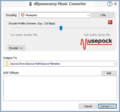

                  No extra settings from DSP. Image of settings attached, note folder settings. BUT other files chosen at random convert fine. If you click the 'Encoder' button it says MPPenc.exe in the Program Files\dBpoweramp\Encoder folder folder.
                  Right - I have the answer but I cannot figure out why. I converted the master flac file (in the root of 'Drive F:' to all the other formats I have installed for a set of unicode test files to test the Tagger I am using. All of them converted fine by using Source Drive:\Source Path\Source Filename. After all, the converter changes the extension so there is no filename clash.
                  With this one file I have now selected Public\Music (which is empty) and it converted fine. So: - Is there a Security or permissions issue at play here? If so why can I successfully convert other random flac files placed in the 'F:Root'?
