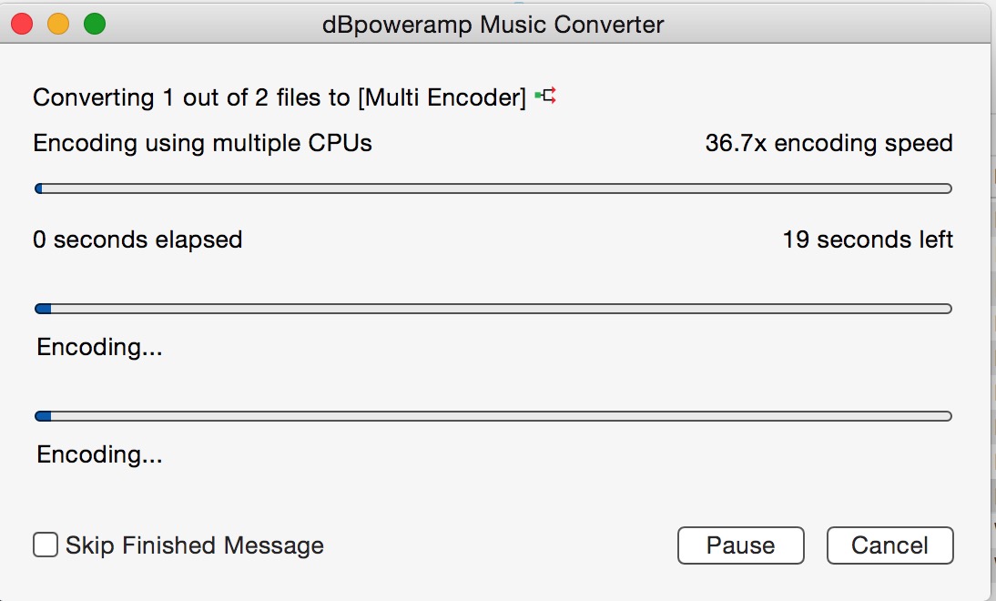

    Hello,
    a newly bought mac dbpoweramp user here. hellooooooo
    I'm trying to convert 24bit wav to mp3/flac using mulit encoder.
    The wavs are character compliant, the settings are standard, and they are being sent to particular folders.
    the convert window opens, small files are written to the folders but the progress stops. i can cancel it (it doesn't freeze) but i can't see why it's happening.
    Not a great start, but from small acorns....Click image for larger version
Name:	ScreenShot 2016-08-02 at 14.45.41.jpg

    Re: VERY NEW USER Only getting a started convert, then it stops.
    Try setting the encoder as 'Test Conversion', does it complete?
      I get this message...
      Information converting to Test Conversion,
      Unknown LIST sub chunk 'TITL' Dropping it. [InitFrom]
      Unknown LIST sub chunk 'GENR' Dropping it. [InitFrom]
      Unknown LIST sub chunk 'YEAR' Dropping it. [InitFrom]
      Unknown LIST sub chunk 'CODE' Dropping it. [InitFrom]
      Unknown LIST sub chunk 'IENC' Dropping it. [InitFrom]
            Converting my 24bit WAV to MP3 (320 cbr), works fine
            Converting to Flac (default), work fine
            same settings using multi-encoder hangs.
            at some point, not sure when, i think restarting/going back to dbpoweramp, i get this error message - but bare in mind, individually converted i don't get any error message.
            i'm 100% certain the 24bit wav is not faulty.
            Error converting to [Multi Encoder],
            FLAC: Error: Audio data contains incomplete samples mid-stream. [dBCoreConverter]
            mp3 (Lame): Error: Audio data contains incomplete samples mid-stream. [dBCoreConverter]
              • 1650
              Good find, thanks for reporting.
              The bug will be addressed in the next update.
              I can also confirm that there was nothing wrong with these WAV files.
                  New beta version posted-
                  This is the last planned part of R15 lifetime. All new features go into R16. R15.7 contains only critical bug fixes. Current version: beta 3 Changes since R15.6: Fixed DSP preset save button triggering the wrong action. Fixed crash when last used codec does not exist [after running R16 alpha versions]. Fixed codec options
                  Fix for this issue included.
                    No longer hangs w/mulit-encoder, in my case.
                    Cool, Thx.
