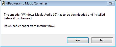

    When I open up the Converter and select my files, it gives me the usual conversion dialog box. The "Converting To:" dropdown contains Windows Media Audio 10, but the option is greyed out.
    If I select it, I get a notice that "The encoder 'Windows Media Audio 10' has to be downloaded and installed before it can be used.....Download from the Internet now?"

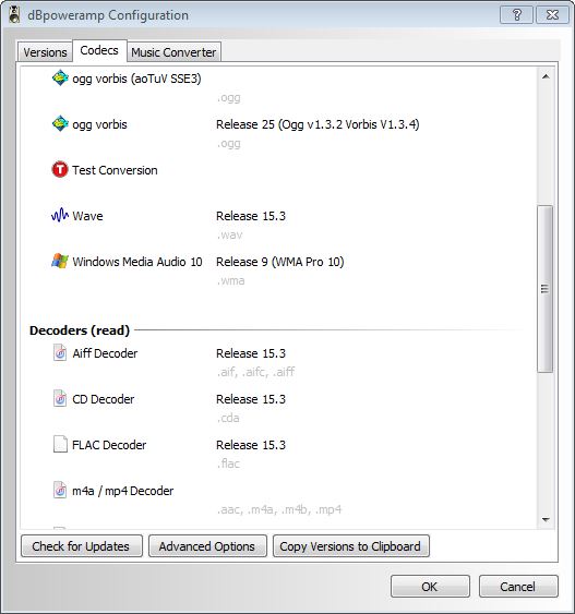

    However, if I run "Configure dbPoweramp" it lists Windows Media Audio 10 as an encoder that is installed already...and the latest version.
    OK...so I reinstalled the Windows Media Audio 10 codec (which uninstalls the current version), but that doesn't solve the problem.

      I downloaded and re-installed from your link. I even installed as Administrator....I still get the same message.
ID:	293149 Window capture showing codec is installed
ID:	293150 Window capture showing message I get when trying to use WMA
      Other suggestions/diagnostics?
