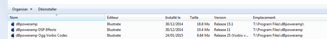

    Hello !
    I'm using DBPAMC R15.1 64 bits with win 7 64 bits and my antivirus is avast.
    My problem is that i cannot convert files to vorbis anymore (which i used flawlessly as my default choice for the 5 or 6 past years).

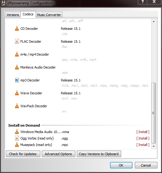

    The latest ogg vorbis codec is installed on my system, but when i run dbconfig.exe, it's still appearing in the "install on demand" section and not in the "codecs installed" area (see screen captures).
    The usual quality options are not showing when trying to convert a file (any file, be it flac, mp3, wave…).
    Both regular vorbis and AOTuV have the same problem.

Name:	INSTALLED PROGRAMS.png
ID:	296917 Click image for larger version
ID:	296918 Click image for larger version

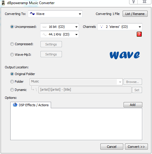

      Thanks for your answer.
      Unfortunately, wave, flac, lame, and some other encoders are working properly.
      No change with vorbis even with antivirus disabled.
      Would you have other suggestions ?
