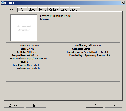

                AAC HEv2 44khz and 48khz DEFINITELY work on iPod Touch 5g, as this is mostly it contains at the moment. Screenshot below demonstrates DBPowerAmp 14.4 and Nero Codec accomplishing this.
                I will downgrade to 14.4 to restore proper AAC encoding as my 15.1 reference AAC encoding is clearly inferior.
