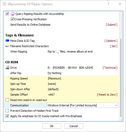

    Re: Pioneer BD-RW BDR-UD04 Inaccurate Rips Every Time
    CD Ripper >> Green Options button >> CD Ripper Options
    right at the end of the list, set communication to 'Windows Internal (for limited access)'

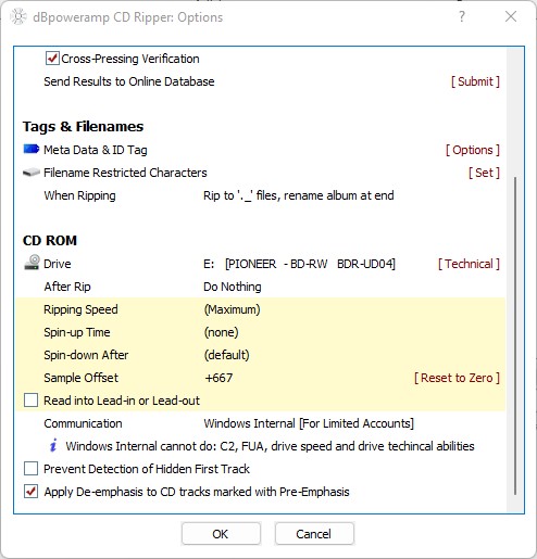

            Tried?
            Hi, yes changed this option as suggested -Click image for larger version
Name:	dbpoweramp options.jpg

              #21
              Tried?
              Here is an image of the options when I changed it, there is a message below the option which I hadn't noticed before -
Name:	dbpoweramp options 2.jpg

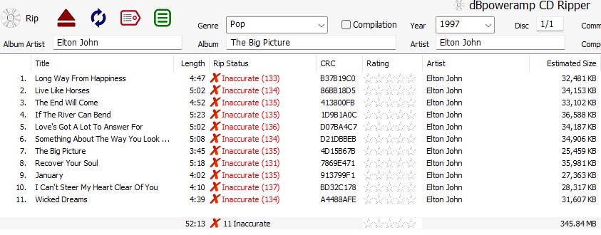

                              #29
                              Am I right thinking that it is inaccurate, the AccurateRip CRC does not match the other programs?
                              Hi, I have ripped a CD with dBpoweramp, CUERipper, EAC, and Media Monkey (all integrate with AccurateRip)
                              Only dBpoweramp did not produce an accuraterip file.
                              The CRC for the other rip tools were all the same.
                              Also see that the AccurateRip DiscID is the same from each of the other tools.
                              Here is the dBpoweramp screenshot
Name:	EJ The Big Picture dBpoweramp.jpg
