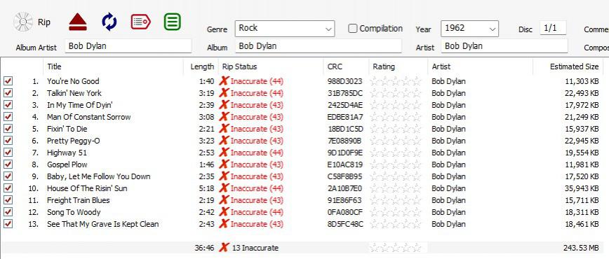

    Just got a new Verbatim KIAB, which shows as a Pioneer BDR-UD04 in dBpoweramp. On first use it did the Accuraterip configuration and set the appropriate offset of +667.
    However, when I tested the drive with multiple CD, every track returned a rip status as inaccurate.
    I have another drive and tested the same CD, all ripped flawlessly.
    I am on 17.7 of dBpoweramp, and did try reverting to an older version, but that also had the same issues.
    Is there something I could do to prove the drive is at error?
    Here is the technical info from the CD Ripper Options
    Manufacturer: PIONEER
    CD Drive: BD-RW BDR-UD04
    Firmware: 1.14
    Serial: 20/06/15
    Maximum Speed: 4234 KB/sec (x24)
    Current Speed: 4234 KB/sec (x24)
    Spin-down After: Never
    Buffer Size: 3.91 MB
    Accurate Stream: Yes
    C2 Error Pointers: No
    Reads ISRC: Yes
    Reads UPC: Yes
    Thanks in advance for any advice.

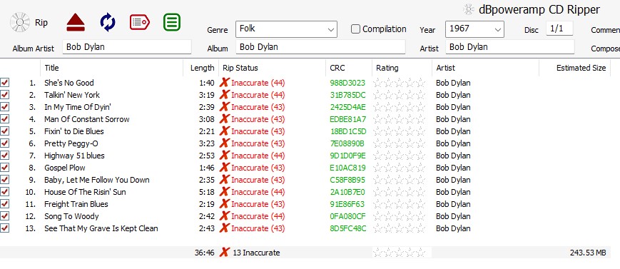

                          Hi Spoon, same results.
                          Here is an image of the default results
Name:	Bob Dylan Rip-3.jpg
                          I also tried Secure Mode and created a log file (couldn't see how to do this in burst mode)
