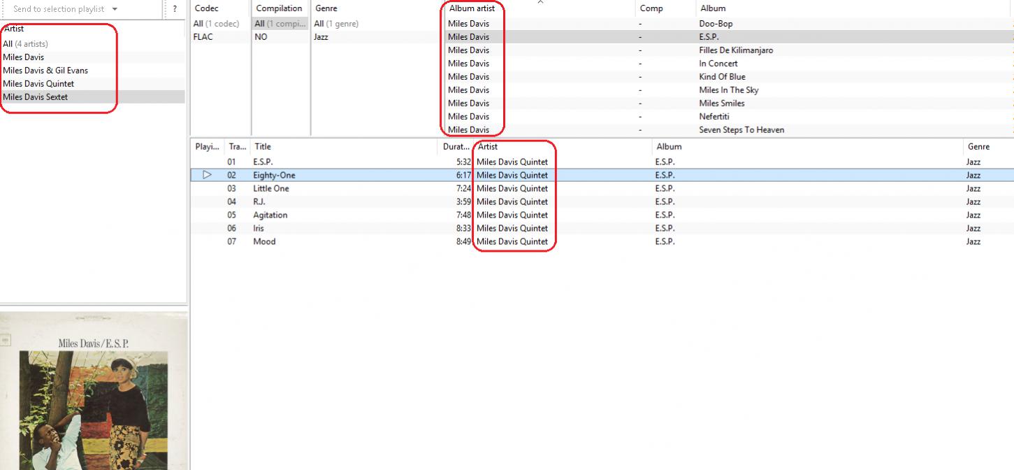

      You can do whatever you want of course. It's not a law of nature. But that's the only thing that makes any sense to me. Personally, I don't use SORT tags at all.
      Yes, I suppose so. I just like to see what other people do and then end up doing a bit of everything. Like pickin' the best bits I like most! Paul.

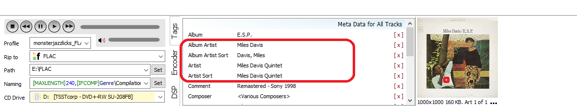

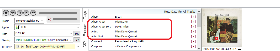

                      Hi, Have gone through all 25 x CDs burned to date and - using the 'EDIT ID TAGS' facility - checked and amended all data as saw fit. Still took over two damn hours! I do have some artwork issues though (which I will post over the weekend in the dedicated thread). Goodnight!
