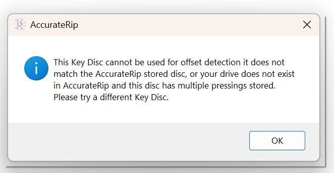

    I then realised that I hadn't set up accurate rip - it was still set to "Burst" mode. So I turned on Secure ripping, but now matter how many CDs I've tried (6 now), I can't get it to detect offset, instead showing the attached error.

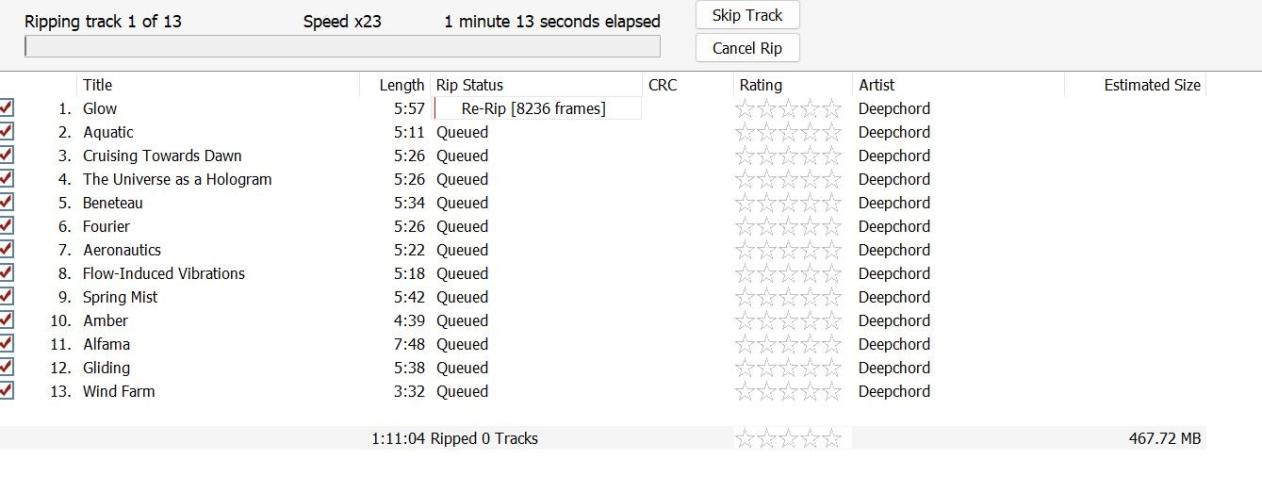

    If I don't set up accuraterip, but use "secure" anyway, it always tries to re-rip several thousand frames near the beginning of the first track - even on brand new discs that ripped perfectly using the same drive on my old PC. I haven't bothered letting it finish re-ripping (also see attached).

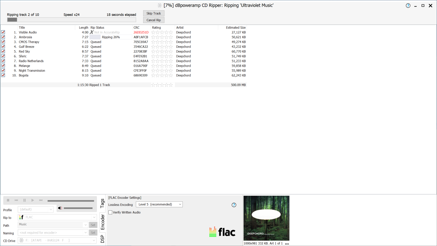

            Also, every time I rip a CD, I get a different CRC (see attached).
            Please have a read of the thread I linked to above where I have documented the different approaches and scenarios (Windows 10, Windows 11, Ubuntu 25.04 as "bare metal" installs, and Windows 11 and Ubuntu 25.04 as VM installs, different cables, different SATA ports).
