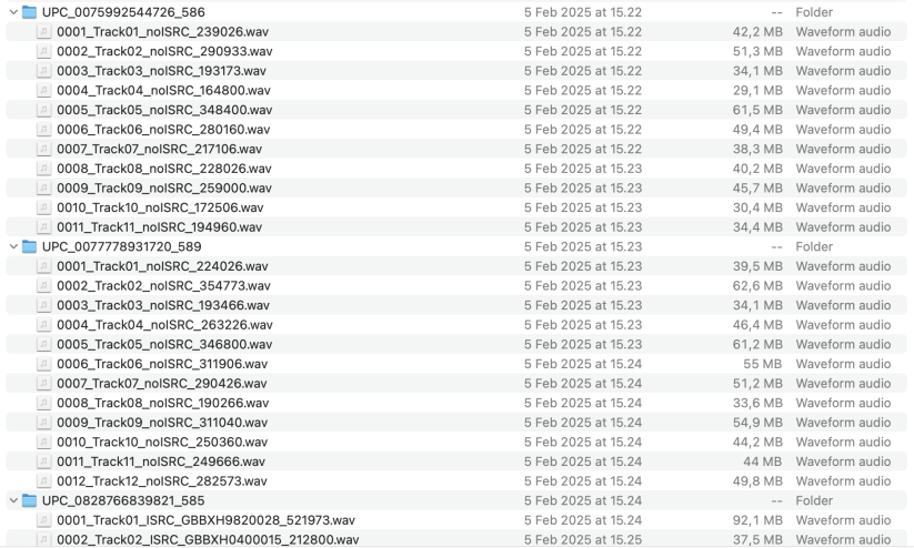

    I think I discovered a bug in the newest version of Batch Ripper.
    The naming scheme is the same as I have always used:
    [SETLEN]2,48,,[disc][][SETLEN]2,48,,[track][]_[title]_etc.
    Batch Ripper (more often than not) names the files 0001, 0002, 0003, etc. instead of 0101, 0102, 0103, etc.
    I haven’t figured out what exactly the pattern is, but I have to manually rename every file. Also problematic with multi-disc albums.
    Has anyone else encountered this, and is it maybe something Spoon et al. might look into for a future update?

        I don't know how cdripper/batchripper determines a disc number, but when ripping the same cd's in cdripper (not through BR) with the same nimbie drive, the files are named correctly.
        The CD's I tried for this test:
        Faithless
        Paul Simon
        Neil Young
        Daft Punk
        Wings
        Groove Armada
        So CD Ripper still names the files correctly 0101, 0102, etc.
        It's a problem I first encountered after updating to the first 2024 update to BR.
        I'll attach a screenshot. I ripped on a win11 machine, although the screenshot is from OSX.
        Can I get you to look into it?

                          It still does not address why CD Ripper and Batch Ripper yields different results, when the settings are the exact same.
                          For none of the above tests have the cache been enabled as a provider in either program.
                          I set the cache size to 0MB, cleared track metadata, and refreshed with no metadata providers. Not even cache..
                          CD Ripper still names the files correctly:
                          0101, 0102, etc.
                          Did the same exact settings in BR. Disabled all providers in BR, and checked that the profile settings in CDR is still the exact same as before.
                          BR still names the files incorrectly:
                          0001, 0002, etc.
                          Still disconnected from the internet.
                          Whether disc number only exists online or is present on the cd seems irrelevant at this point.
                          The disc number is already present with no providers enabled.
                          CD Ripper does it correctly, Batch Ripper does not.
                          If this is not a bug, I would really like to understand the logic behind it.
