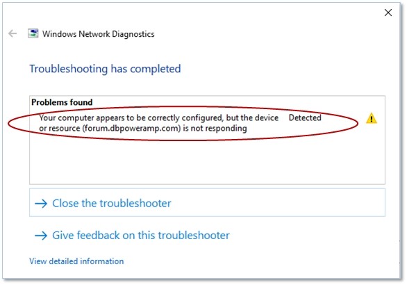

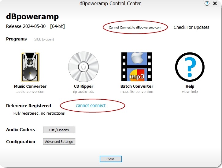

    AccurateRip and dbpoweramp domains were down yesterday. I had the same problems, no AccurateRip, no metadata look-ups.
    Today (05Oct) looks like the issue is resolved.

        • 45127
        AccurateRip was down also for about 8 hours.
