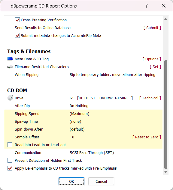

    1 - on the Windows version of dBpower

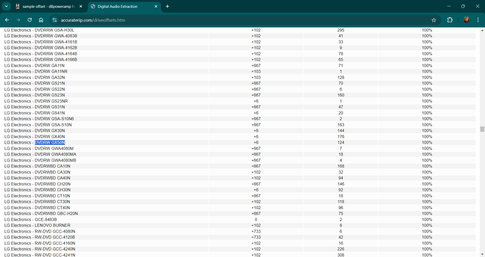

    the [A] both configures on the 1st shot, so no problem, the sample offset of 6 is set ( which is even as per https://www.accuraterip.com/driveoffsets.htm )
    the [B] is shown as "purge" on the https://www.accuraterip.com/driveoffsets.htm , so have carried out the "key" disc procedure & have got a sample offset of 6, here too rips are fine.

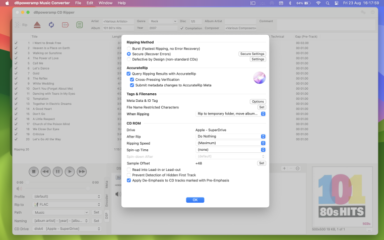

    2 - on the Mac version (OS sonoma)
    the [A] on XLD, i have entered the value of the offset as 6 manually, the rips seem fine & on the drive [B], i have not configured as i don't know what value to use.
    the [A] on dBpower gives me a value of 48, as compared to 6 on the windows version, is that correct & do i use that or am i doing something wrong ?

    A on macOS, did it need 3 discs to configure?
    Have you had an Apple Super drive in the past? with a different drive?
      hi,
      on the Mac OS, for the [A], it did not ask for the key discs
      (if you notice, on the Mac OS, the drive shows as SuperDrive & on the Windows Version it shows the HL-DT-ST DVDRW GX50N)
      yes, i am using the Apple SuperDrive for some time now, in fact i bought a 2nd one, as it seems, Apple is going to discontinue it.
        • 46119
        That is the reason, Apple show the drive as Superdrive, even though it can contain different drives internally with different offsets, as you already have configured a different super drive (and a different make of drive), it would have used 3 key discs to find the offset. This time, CD Ripper did not see any changes.

              on the link the drive DVDRW GX50N shows an offset as 6, do i still use a 0 (zero) as an offset ?

                      on inserting a CD, i got the AR screen as attached & also re set the dBpower for Mac OS, it is working wonderful!!!
                      what setting do i use for the mac re rips ?
                      the default is 34 & i had read some where, to use 700 is ok ( please correct me if i'm wrong )
