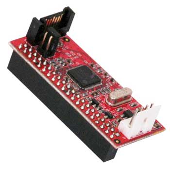

    I am trying to setup some multi-drive robots and need some help/advice on the best way to connect the drives. All of the drives I will be using are IDE drives.
    My choices for connecting the drives are USB, Firewire and eSATA. Here are the questions I need help with.
    1) I know there are still some issues with C2 pointers and some USB/Firewire bridge chipsets does anyone know of any issues using an eSATA to IDE adapter such as http://www.cooldrives.com/serial-ata...-adapter.html?
    2) What about an eSATA port multiplier...any know problems with dbPoweramp and these?
    3) Are directly connected IDE drives the only ones which suffer from the DMA/PIO thing or can any of the above mentioned connections also experience this?

            I have used USB 2.0 to IDE/sata adapters from Vantec that use "JMicron/JM20337" chipset and C2 information seems to work fine. Cooldrives.com looks like they have some IDE/sata converters that use the same chipset (at least from the pics). I would say they should work.

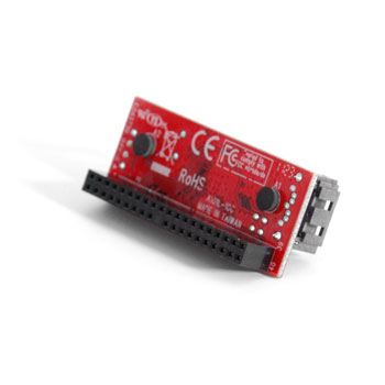

              Hi,i'm using this,UK thou:-
              Looks similar,testing C2 with a scratched disc,says it detects but?
              Using it to connect a Plextor 716A IDE drive,PC as no IDE connections.
              There is another one as well,don't know how good etc:-
              I did find more when i googled.

                So that adaptor works with Plextor and C2 thats good to know. Does it also work with the FUA feature? Have you connected multiple IDE drives with this adaptor through a port multiplier? If so how did that work.
