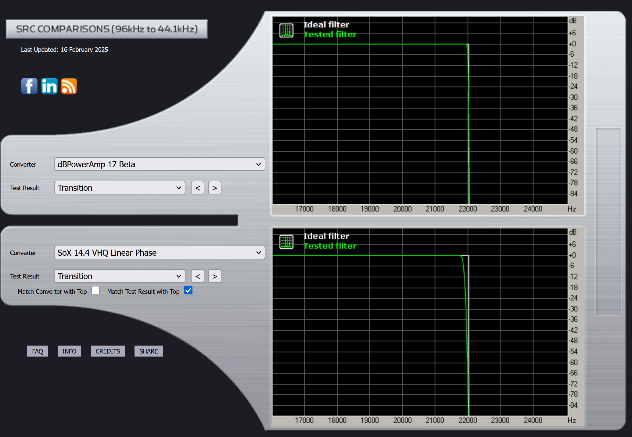

    Sox has a well respected SRC, we test here v14.4.2, very high quality with extended bandwidth (99%):
    Onto the components of the test:
    Very similar. Bandwidth now:

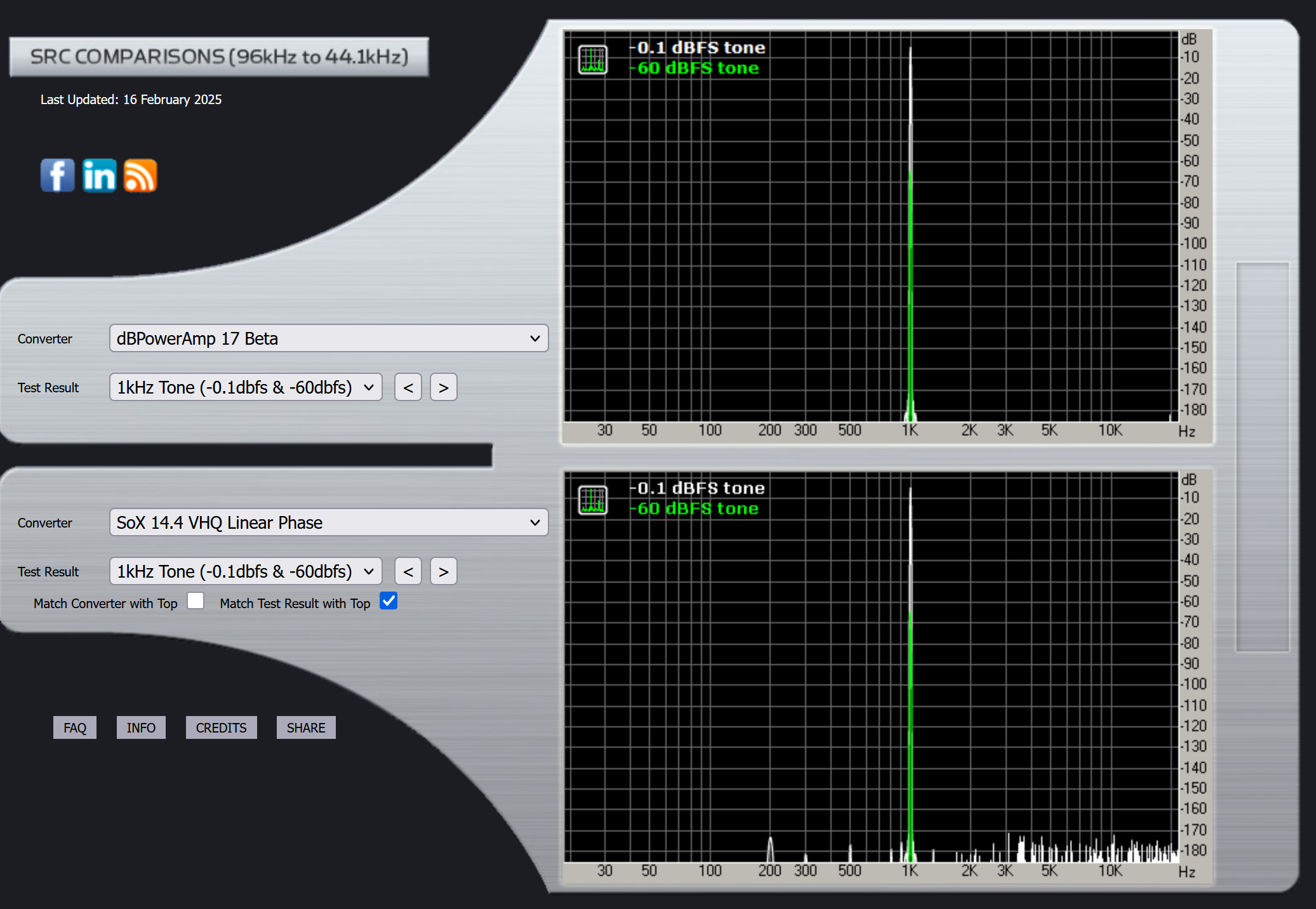

    Here Sox is around 99% preserved. Impulse frequency:
    There is the difference, Sox is likely limited here by the 32 bit float format which is the highest this cmd line accepts.
