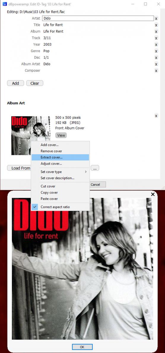

    I apologize if this wish has been requested before (and no doubt it has, because it'd be so useful !)
    I think that the attached image Click image for larger version
Name:	Extract Cover.jpg
ID:	297512 should be self-explanatory for what to me would be a really really useful feature that I would use ALL the time!
    I know you can do it with the DSP Effects etc, and with multiple files, but I would just love a quick & dirty right-click on the image brought up from the dBpoweramp "Convert to" context menu to extract, and perhaps do some basic cover art manipulation, similar to how Mp3tag does it, especially when dealing with a single file.
    It gains top place on my Wishlist

    R17 has:

      O M G ! I've been caught out by the little ol' "..." gig.
      LOL. After many years of happily using dBp, and I don't think I've ever even noticed those little ol' dots.
      Thanks Spoon! I'm sure it wouldn't hurt to have a small icon there to jolt the ol' brain into action. Still, good to know that the "exporting cover art" function is there. Gosh, the number of times that would have sped up my workflow... if only I'd seen those... :/ *sheds a silent tear*

        Spoon. Can I make a small suggestion if I may?
        Add a "Right-click" function to one, or perhaps both of those cover art images (if technically possible), that brings up the same context menu that the three little dots does.
        I've so often right-clicked those images... hoping (praying!) for a menu to pop up.
        If not technically possible (for whatever reason)... perhaps (when sensing a "Right-click") add a small hint to "Click the little dots" !!
        A "Right-click" function would have been more intuitive for me, but even adding the "three dots" next to the "OK" button on the larger "View" pop-up Cover Art window would probably have helped me to locate the function.
