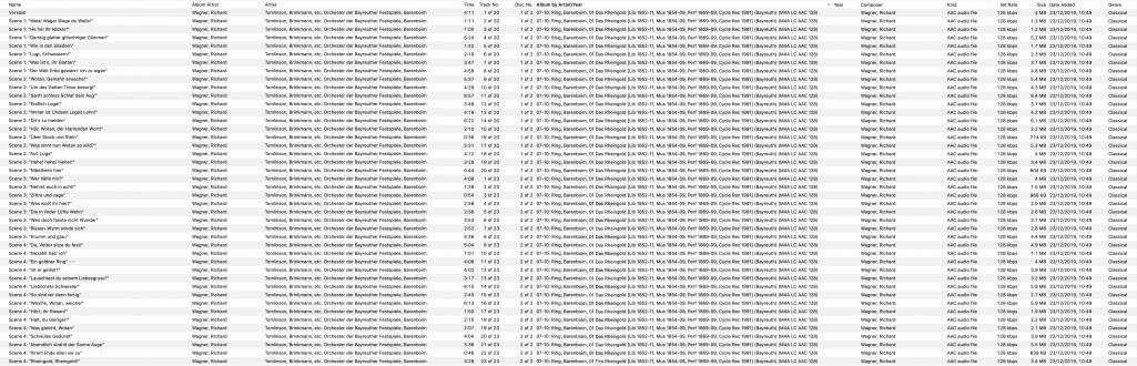

        And finally, this is precisely my point & why I asked the question in the first place.
        If I rip the entire disc as you see it now (in the first screen shot), I can then go into the finder on my Mac & BATCH CHANGE the first set of tracks to scene 1, the next lot to scene 2 etc.
        That means I can do the whole album in 4 hits instead of manually editing 18 or 20 (or more) tracks one at a time.
        I can then use my tag editor software to use the file names as tags & they all get replaced in one hit.
        So my reason for posting is why don't you add batch changing find & replace functionality to that screen in dBpa so that I can do that before I rip it?
        Simples!
        And here's a screen shot of how the album will eventually look in iTunes:

          Re: Find & Replace Tags within dBpa
          That seems to have down-sized it. It's here full size if anyone's interested:
