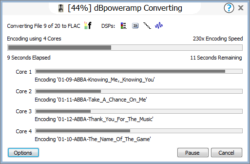

      Okay, but when I tried to set sample rate max to 48khz, files that are equal or below 48khz are displayed with an "Encoding" label in the progress window.
      Maybe those files are not reencoded but it's disturbing.
      Example on my album "ABBA Story", FLAC 16 bit / 44khz:

        Re: Conditional encoding and ID tag processing
        They would be re-encoded, however it does not matter because you are encoding lossless-to-lossless, the end result is identical to the source file.
