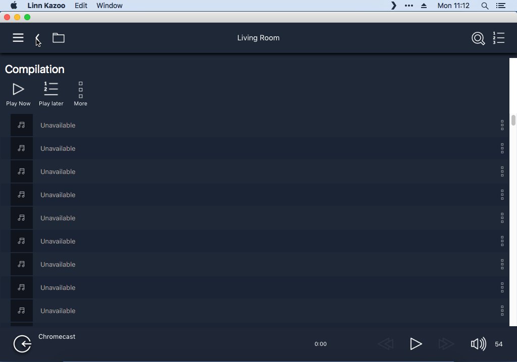

          As I'm testing on macOS, I'm now using more features of Asset UPnP that I've not used before. One of which is the compilation support. Because I've not really used it before I'm not sure if I've uncovered a bug in the beta or I've just got a problem with my tags, but I have an issue with using compilations.
          This screenshot shows it best:
Name:	Unavailable Compilations.png
          Does anyone know what could be causing this? If I scroll down the list I do eventually get some albums listed, but it's a pain to scroll past entry upon entry of 'Unavailable'.
          Any help would be appreciated.

            #35
            Re: Using custom tags in R6 seems to not be working for me
            What happens if you go back up one level, then select compilations again?

              #36
              It still displays the same, with lots of 'Unavailable' messages. If I scroll down I can find albums listed, but if I start scrolling up and down the list sometimes the 'Unavailable' message disappears and just a blank entry is displayed (this appears to be random!).
              When I get home tonight I will try with BubbleDS on my Nexus 7 to see if it shows the same strange behaviour, just to make sure it's not a control point issue.

                #37
                OK, so I tried with BubbleDS on a Nexus 7 and also Linn Kazoo on an iPhone and the Nexus 7. BubbleDS showed the compilations correctly with no issues. Linn Kazoo, on both platforms, showed 'Unavailable' items in the list but did not show blank entries.
                So it appears it's an interaction with Linn Kazoo when showing compilations that causes the 'Unavailable' items to be shown in the album list.
