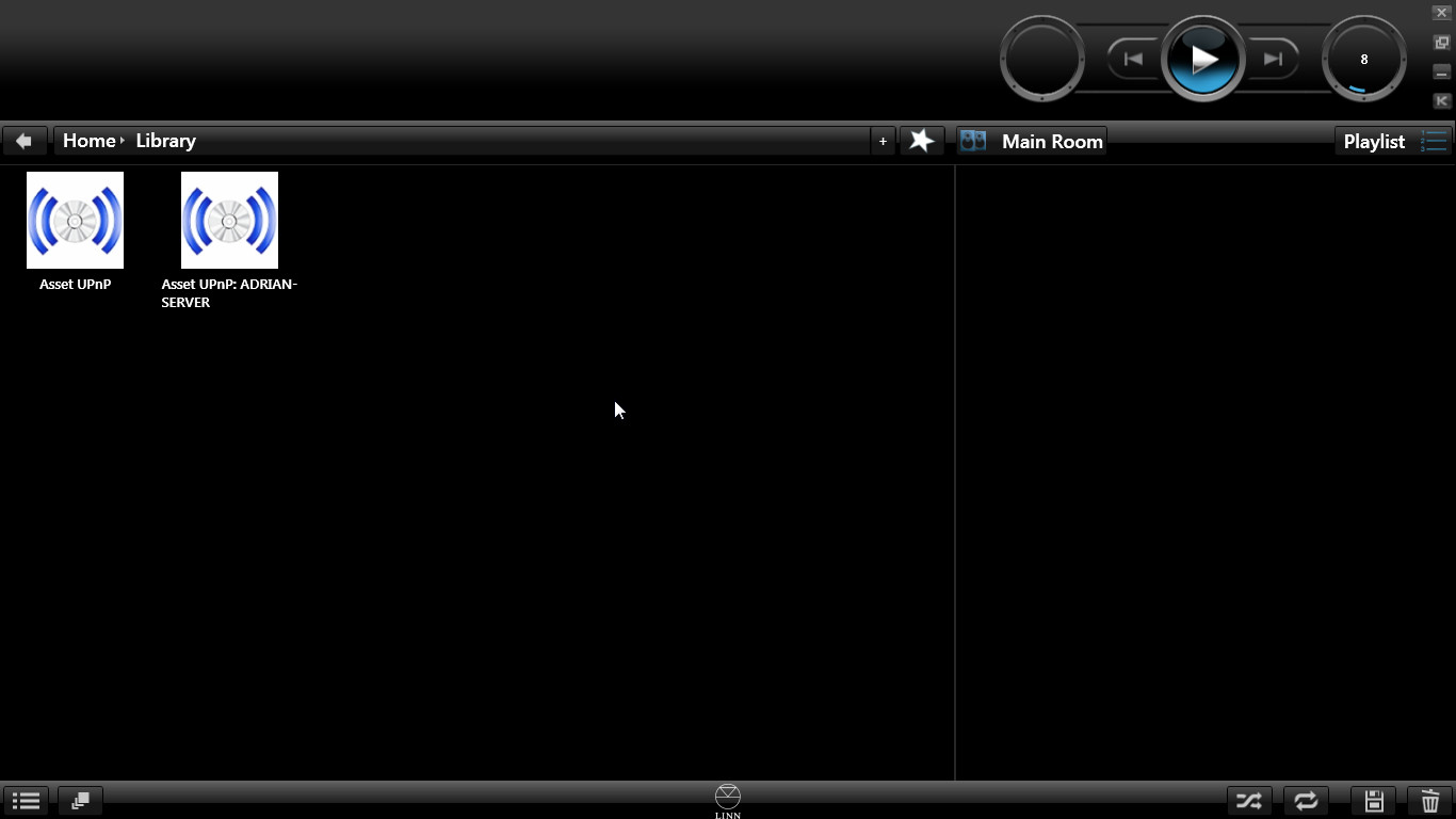

          Something weird is going on with the latest Asset 5.0 Beta 2.
          Some weeks ago, while using version 4.3, I changed the name of the Asset UPnP identification to different name 'Asset UPnP: ADRIAN-SERVER'. At some point after that the Asset UPnP indentification reverted to the default 'Asset UPnP' without me changing any of the settings (presumably after updating to release 5.0). In the last couple of days after installing 5.0 Beta 2, the old name identification name has reappeared along with the default, even though only the default is specified in the configuration page.
          I always uninstall the current version of Asset before installing a new version.
          Here is a screenshot of what appears in Kinsky:
          When I reboot the computer running Asset, and look in the Windows 7 x64 task manager, there are 4 instances on Asset-uPNP.exe *32 running (2 under local User Name and 2 under SYSTEM) and the same if I then use the <Restart Asset> option.
          Something is not working as it should be here....

            Yes you have 2 lots of Asset running (each Asset runs 2 assets). For this to happen they must be installed to different folders.

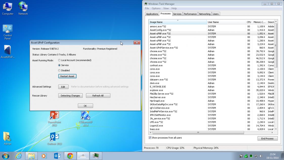

                  Re: Asset UPnP R5
                  I managed to reproduce the earlier problem I had in post *64 again this evening. It occurred after first setting Asset to run as a service with a different identification name (Asset UPnP: ADRIAN-SERVER), then switching back to a local account with the default name (Asset UPnP).
                  After adding around ten music albums to my collection, then reinstalling Asset 5.0 Beta 2, it reverted back to running as a service with both the service identification name and the local account identification name displaying as Media Devices. Again, there are 4 instances of Asset-uPNP.exe *32 running (2 under local User Name and 2 under SYSTEM) with ALL instances of the process file location pointing to the same default installation folder.
Name:	Asset Problem.jpg
                  Please advise on any further information you may require to help sort out this problem.
